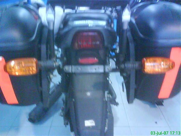

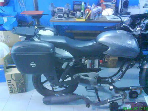

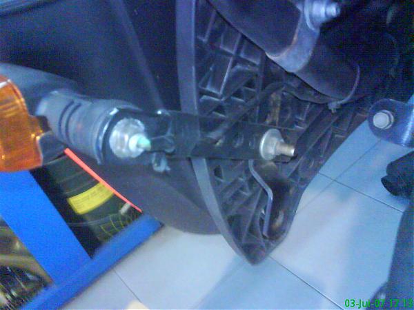

Here is what i mean by "pulled back".
149 is the overall view. as you can see, its pulled back quite abit. I think the pillion will be rather comfy with the generous leg room. :)
146 is the rear view. as you can see, the lights are installed on the side box rack.
147 is a show on how exactly its installed.
