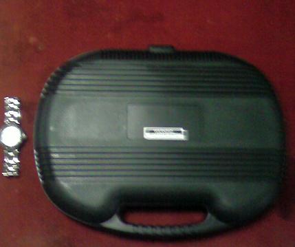

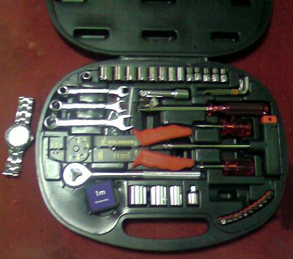

if u guys are into DIY, shld get a simple tool kit. only $16.90 at tuas mobile station. it costs $23.90 at mustafa!!!! im very happy i got this kit becoz this kit is everything u need.
u can dismantle the entire bike with this kit. if u guys are interested u can buy one. so during the DIY session, we dun need to wait wait and wait for the tools :p

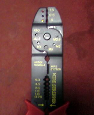

the crimper is the most impt one! haha with tat i can DIY many stuff correctly

ok, size 10 open end or close end spanner will so. to remove the head crowl for UG2
Eh u forgot to mention socket wrench/spanner (10mm)

all u need is a + screwdriver, size 10mm socket or spanner.
