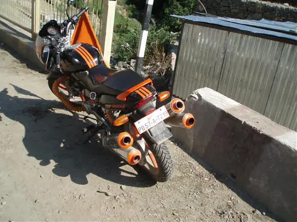

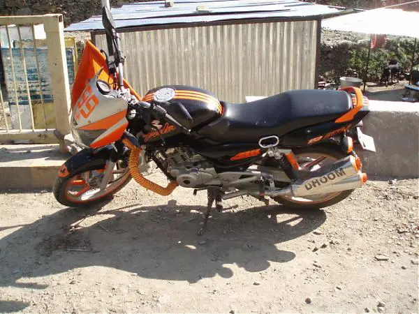

http://img181.imageshack.us/img181/3914/p6240054lt5.jpg
Wat the heck?!
Super 4 has 4 exhaust headers merging into 1 end can. This Pulsar has 1 exhaust header branching out into 4 end cans!
:faint:
Wat the heck?!
:faint:
I wish I can mod it like that. Looks nice!
Wat the heck?!
:faint:
fugly sial
No more regrets.
Well its certainly unique, i'll give the guy who made it that. :/
