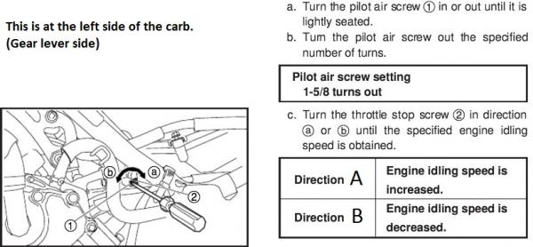

btw lim, where can i find the idling knob, me intend to try to lower it, hope to improve the FC. Currently best achieved the 44km/L on 95 spc, fully stock parts, 2.5 year old bike.
unscrew fairing to peep inside but cannot find the knob that can be turn by fingers
Who told you it can be turned by fingers? By any chance you are Inspector Gadget? :cool:

wah, need tools to tune down idling time.
me previous bikes comes with finger knob type to lower idling time leh
What to do? Feel free to submit your feedbacks to Yamaha engineers. :angel:

got picture show me anot?
Don't say I never help ah. You owe me one Milo Dinosaur. Good luck. :cheers:
