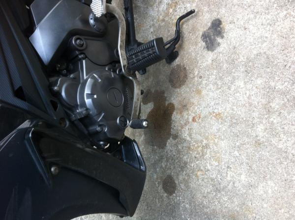

Hi fellow bikers, just realized that my EO is leaking, so stressed up now, can anyone advised me on what to do? Really appreciate if anyone could help .
Leaking from where? Engine casing? Oil filter casing?
ah wan, how to see if its from engine case or oil filter?
Snap a photo & upload it up here. Most probably need to change the gasket or rubber seal, depending on where the leakage is.

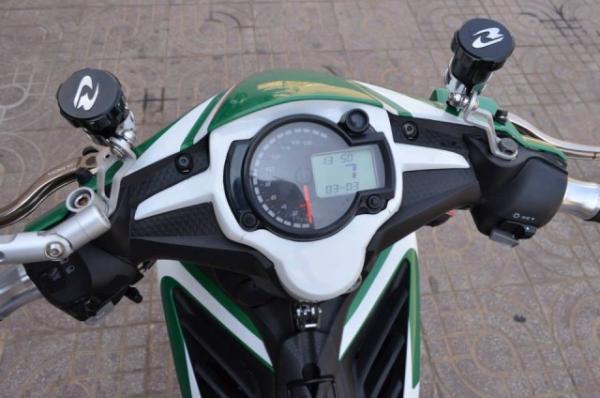

Where can i change from [ATTACH=CONFIG]280016[/ATTACH] to this [ATTACH=CONFIG]280017[/ATTACH].
Do i need special mod? or where can buy the whole thing. it look so fit in lor..
Moulding & fabrication. Many bikeshops can do this.

U see the leaking is like that.
[ATTACH=CONFIG]280039[/ATTACH]
Looks like the screw that drains out your EO is not properly tightened or a worn out rubber seal. Head to a bikeshop and get it checked.
Will that cost much?
If the drain screw is not properly tightened, just need to tighten from the mech.
The rubber seal should be quite affordable if worn out.
We're all on a 2B bike so costs aren't really that high to start with. :)
Edit: most probably you'd have to either top up the EO or change the EO. wouldn't be exorbitant too.
No. Go back to the mech who last changed your EO and ask him to check. He either did not tighten properly or the thread of the screw is misaligned or rubber seal damaged.
Oh, I recently just change EO, so should be the mech never tighten up the screw?
