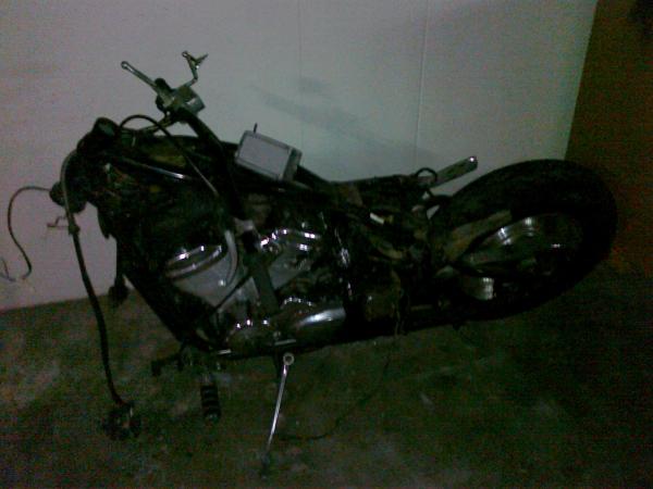

The teardown is more or less complete. Pistons have been removed.
The 4 con-rod end caps removed, revealing the pistons in the cylinder. The caps had to be knocked out softly with a mallet. With that, the crankshaft is removed. The driven gear on the top left was simply lifted out from the assembly. The pistons cannot be simply removed from hereon. They have to come out from the top of the cylinder, not the bottom.
Master Marcheline, can you educate me on this? :) I believe there must be a reason behind.

Anyone can do this, trust me. Sometimes, it takes a lil realization that the bikeshops factor in high labor fees into the parts that they sell. In any case, it needs to survive, but so do us consumers. Added pluses, you learn more about your bike and the tools stay with you for life.
http://i1006.photobucket.com/albums/af182/wadafark/Cylinder.jpg
For the Yamaha engine at least, the cylinder bore does not extend all the way thru the crankcase. The cast protrusions from the lower half of the crankcase block the pistons from coming out from the bottom. Me no master hor.. Hoonda, Kawi and Suzi engines I haven't learnt yet.

Understood, compact one piece cylinder block cum upper crankcase casting. I bet the there are not much metal between the cylinder bores.

For my Honda CBR11xx engine the piston also comes out from the top due to the cast protusion..I think most engines have that..Even the diesel forklift engines have that.

You're right. The cylinder bore is a hollow metal casting about 5mm thick, with an aluminium sleeve about 2mm thick (Total 7mm). The inner part which contacts the piston rings are lined with nikasil.

Thanks bro, it feels great when I learnt something new :thumb:
