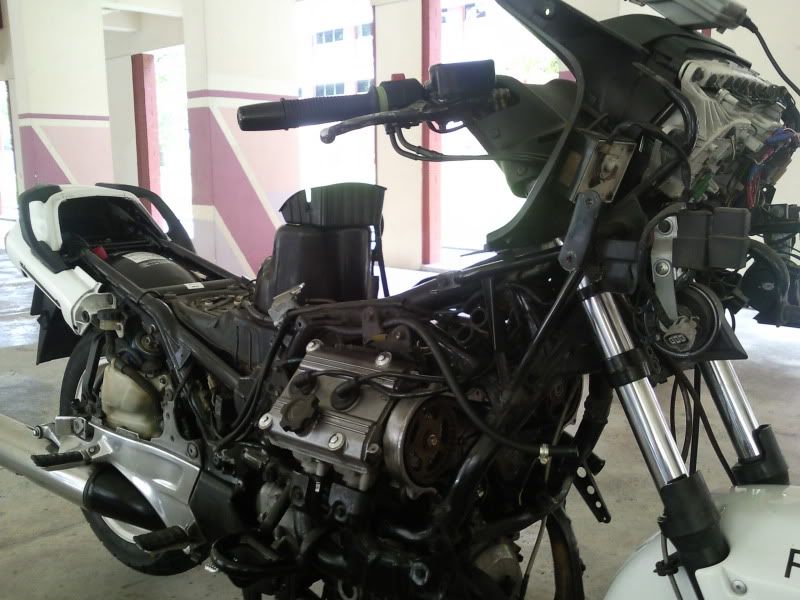

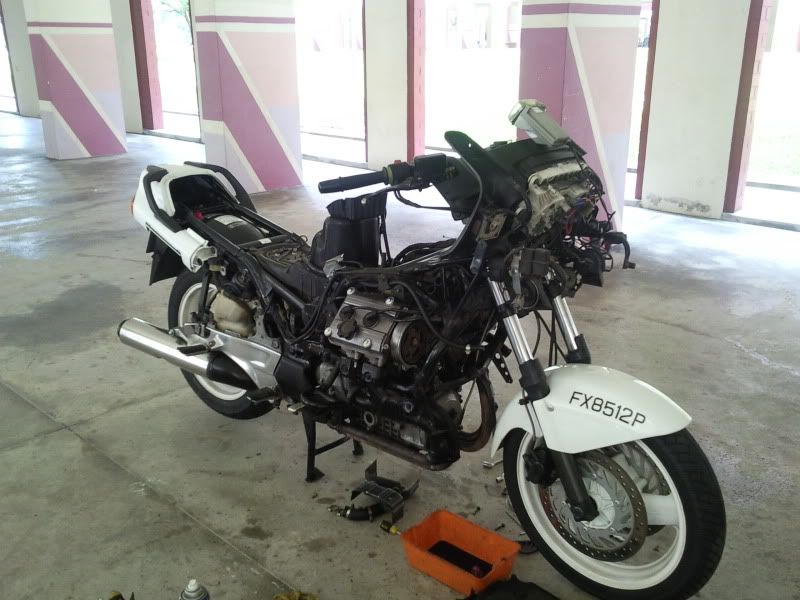

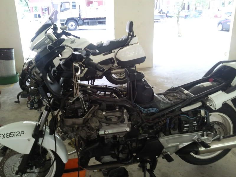

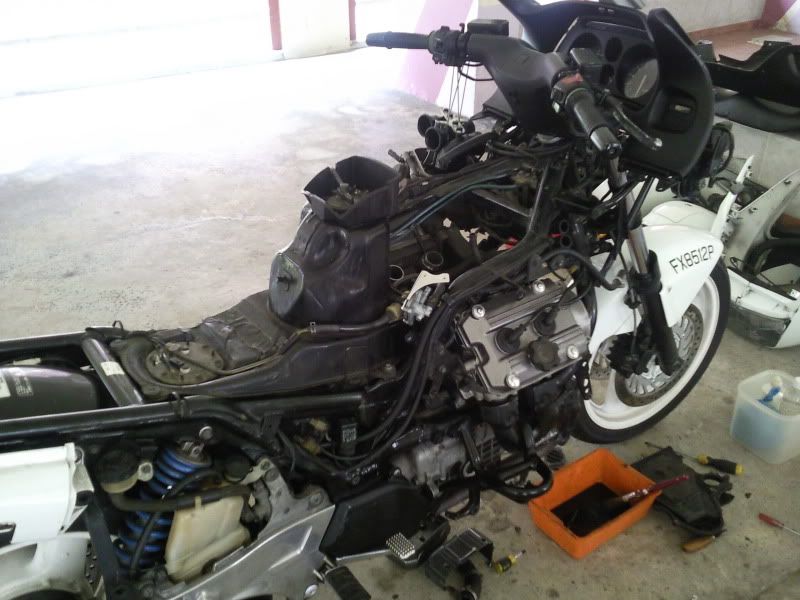

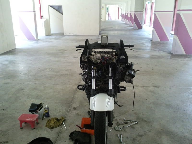

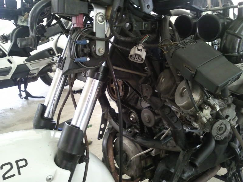

SwingArm need to be out. Drive Shaft, finial drive. u might to change all the Oring, oil seal & rubber horse. etc...Why i know? i just did my...
Terence STX :thumb: +65-9072-9070
Bro, u strip yr at the void deck ah...u HDB officer come might got fine...
So what are u doing ? Change Timing Belt, manifol, water hose.....??? I would interest to come down to see...call or sms me can ? 9851 7927
dont worry hdb officer you didnt dirty the place .today just change the top engine head gasket sorry no photo ok next time sms you .mostly we like diy our bike ourself,you can save alot of money just to do it yourself.
Why change the top head gasket ? leaking ?or jus change since remove!!!
did u do the tappet clearance check ? That is alot of procedure need to follow..

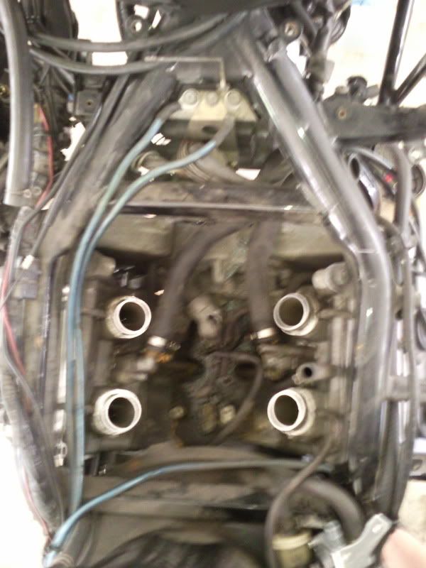

hi guys. my st 1100, 2001 version has abit of misfiring issue. when idling, i throttle, once in awhile will have a sparking kind of sound, like "piak piak". a few ppl have heard n most say its misfiring. i changed spark plugs already. also checked the spark plugs also, after using for like a month. no problems/issues as seen from the spark plug. so most likely it is some carb tuning issue.
ah chong from planet says its normal, n no problem. i know it is fine, but then most say it cause abit of increase in petrol consumption. my consumption is about 15km/l. so i guess it really could be better. anyone know if i can diy n tune? or bring to gopa or rosli or bikeworks?
Bro,
Very high chance r ur intake manifolds cracked due to ageing, resulting to too much air sipping into engine during combustion causing too lean air fuel mixture therefore backfiring boobs. Intake manifolds r the 4pc a set of rubber clamp to hold the carburetor onto engine.
Can be easily DIY with simple tools & some grease.
