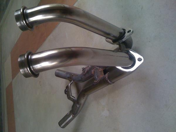

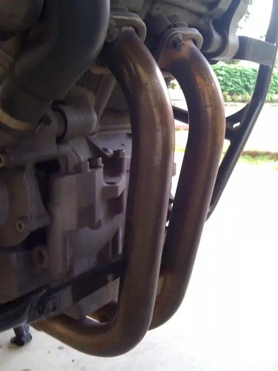

D.I.Y. mission today : Reviving the Lifeless Stainless Steel Header...

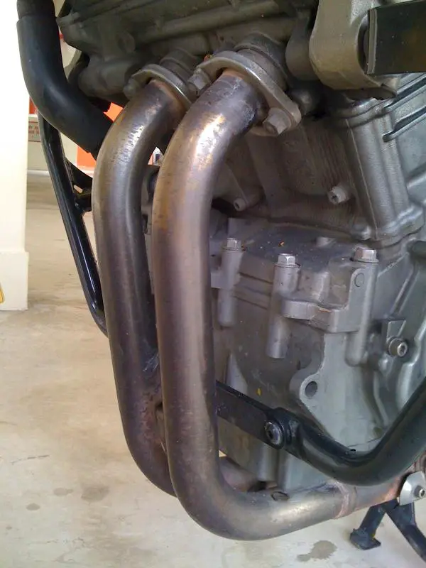

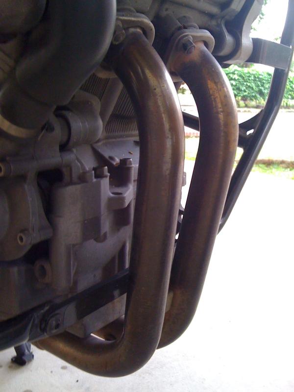

Part I: Spending 15mins dismantle the header, quite easy tho...
Here the picture of the header before reviving...
Edited by heaven51
http://i426.photobucket.com/albums/pp350/glennkoh/TDM900/TDM.jpg

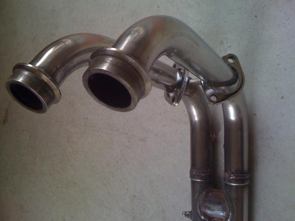

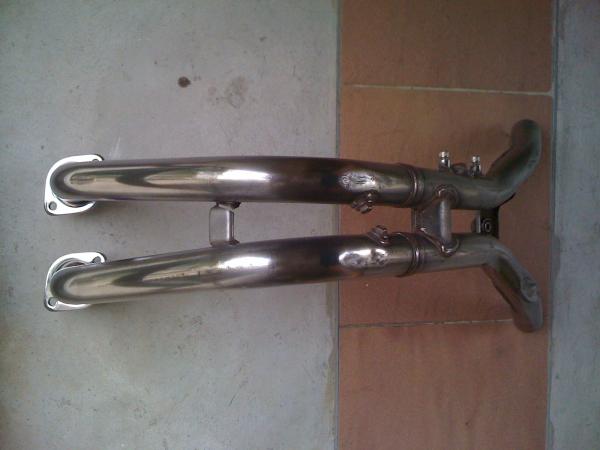

Part II: Where the hardworks being...
Spend about an hour, sanding down the header using green wool (for dirts) and fine sand paper for removing the burn mark...
Final touch up using metal polish to install life back into the header again.
Even thought its drizzling outside, here I'm sweating profusely... Tough work cos didn't use any machinery only HAND POWER...
At the end of the day, satisfaction level : 95%...
Here the pics to share...
Edited by heaven51

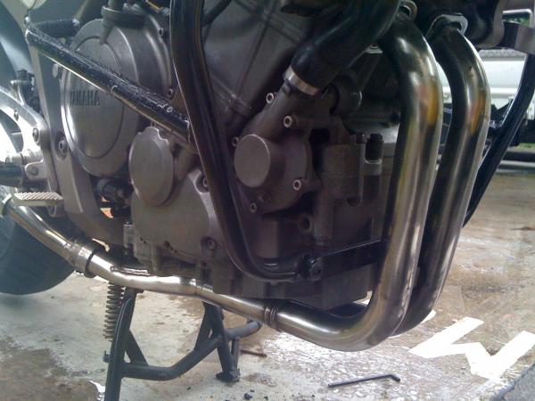

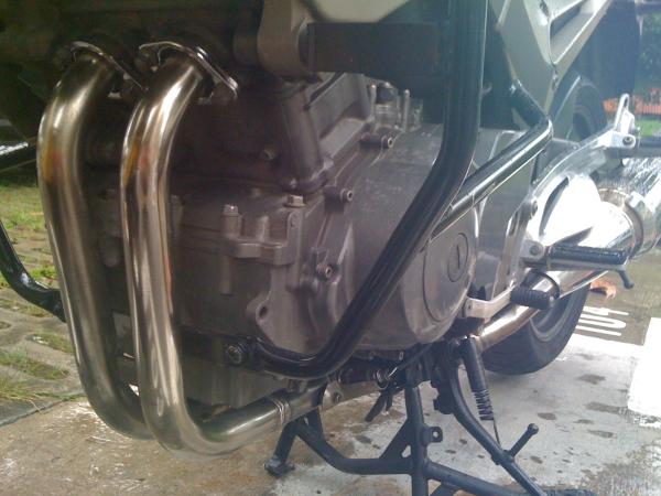

Part III: Installing back the Header...
Takes about 15mins....
Here the final, after mounting it back...
Overall takes about 2hrs...
Edited by heaven51

Meguiars NXT Generation® All Metal Polish, get from NTUC... Sound like commerical marketing... must claim advertising fees from them already...

Bro, do u have the picture for the green wool? i want to know how it look like. Where to get the green wool?
Hi Bro Nukye... Green Wool is something most of our kitchen essential scrub, rough, green in colour...
Mama using it to scrub stain on the pot left behind after heavy cooking...
Use it to clear all the soil/mud stuck to the header... Easy and excellent...
Mine, I think has being there for the past 8yrs...
Of all, its quite cheap... but need HAND POWER...
TAAADAAAA... This is GREEN WOOL...

I use Autosol and cloth for the mid-joints of my exhaust of my Duc (ok - its different bike coz I'm still waitin to sell it off so I can get a TDM).
Here's before:
[ATTACH=CONFIG]174553[/ATTACH]
... and after:
[ATTACH=CONFIG]174552[/ATTACH]
I never thought of using the common kitchen green wool! It would have save me lots of time :) Thanks for sharing, heaven51.
