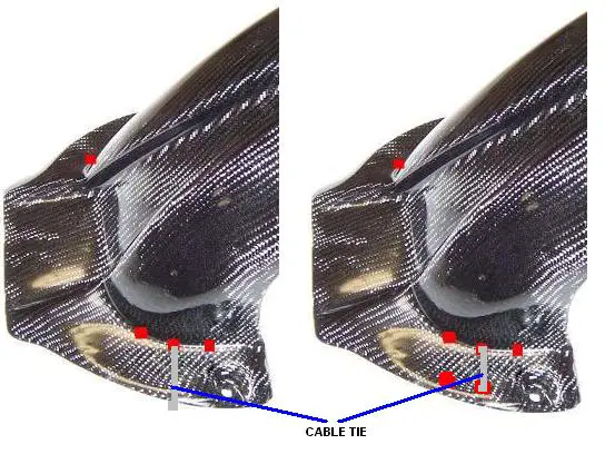

Guys, I need your help.
Recently, I purchased a carbon fibre rear hugger w/o chain guard frm ebay.
Upon receiving the good, I immediately tried mounting it on my swingarm. But to my surprise, it juz couldn't fit at all because 1st, even after removing the chain guard, the hole for me to secure the hugger was juz too far away. The right side of my swingarm didn't even have a hole for me to firmly screw on my hugger.
Rite nw i'm quite confused as to how am I to mount this hugger on my bike. There was even thots to drill 2 hole on my swingarm in order to mount it on but i later dismissed it bcoz i feel that safety would be compromised after drilling the holes.
My question now to all is, do you guys have any kind of constructive suggestions as to how I can mount this hugger onto my bike besides the drilling idea?
Below are 3 pics of wad my hugger looks like.
The pic below is the modification of the swingarm which I was talking abt. The pic actually shows the part of that swingarm has been drilled into in order to mount the hugger.
Hope u guys can give me some gd suggestions.
Thanks all in advance.
:smile:
Thought i bought my hugger locally and its a different design from yours, no problem fitting. But the similar points i want to stress is,
1. drill holes if u must on the hugger,
2. use glue to stick rubber tapes on the underneath of the hugger where it is touching ur swing arms(prevent movements),
3. then cable tie them.
If u need the rubber tapes (not easily found in local stores), i can bring them for u this coming fri for weekly meetups, but i cant confirm as i may have to work OT.
Else if u find everything too complicated and troublesome, u can just give me the huggers for free :angel:
yo Tish, tks for the suggestions n ur offer for those rubber tapes. Ur idea on using adhesive tapes on the underside of the hugger didn't occur to me.
As for drilling holes on the hugger, prob is that the hugger is too short to reach even the mounting hole for the chain guard. But if ure saying drill holes on the hugger to attach brackets, den tat would be feasible.

Ya, i was refering to drill holes at the inner part for cable ties, 2 ways to drill, either drill 2 holes for each cable tie or drill 1 hole for each cable tie.
But it might weakens the carbon fibre material and it may look ugly.
Drilling holes for brackets, u need to find other source
Dispite all these, u might also want someone to drill holes in ur swingarm, but will it weakens ur swingarm ?
Maybe u want to see mine this fri first.

If cable tie gives a sore eye..
den get a 2mm alu strip. D.I.Y shd solve your prob. i have some alu U-bracket. but need to drill the hole to your own expectation. Let me know if you need it.
tks in advance bro. were u referring to aluminum strips?
I chanced upon this pic while browsing for bikes wif huggers fitted on with custom fabricated brackets.
http://i135.photobucket.com/albums/q154/kelvin_luffs/CustomFabricatedBracket.jpg
Is it something like this? Or is it those long long strips filled wif holes in it?
