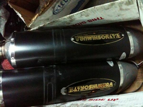

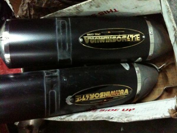

i'm selling off hayabusa year 08 - 10 exhaust..
brand: yoshimura oval cone(black)..
price: $1200(nego)..
condition: 8.5/10..
for interested n serious buyer do call or msg me for viewing..
tankz..
do help me spread around..
contact: fARz
hp: 84885466
