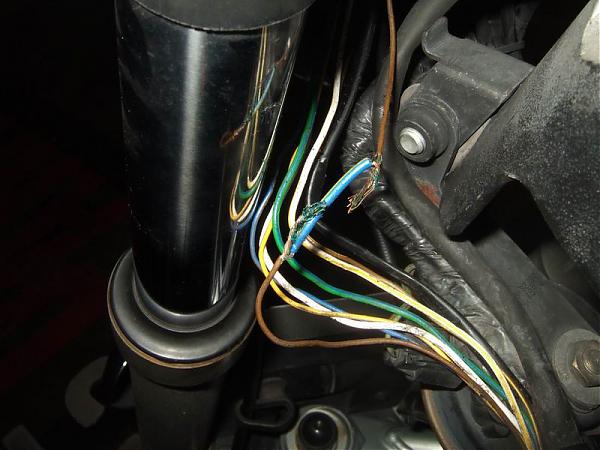

just morning my bike due for inspection (14 july), realize my left signal, hazard light and horn not working. stop one side to check and wonder if i still should go for inspection. decided not to go, but after move off to office, everything seem ok. so i go ahead, luckily pass the inspection. just today got time to troubleshoot, finally found out the culprit (attached file). going to re-insulate related wiring tomorrow.

Looks like some sort of abrasion against the harness. Ya, heat and age plays a part in destroying wiring harness. A complete strip down is not necessary but cleaning up the gunk on the harness with solvent and then re-wrapping it is important.

sorry if i didnt make myself clear. my point on the picture is the wire connection by hand twisted only, that cause intermittent problem. coz i dont have portable soldering gun, have to use crimp to connect the wire. And i also found out another 2 wire on right hand connect the same way, have to re-crimp. hopefully no more other wire connect that way.
Yes, I came across such "repairs" when doing up an old bike. I have also seen rusty nuts being "treated" with silver paint!
The proper way I am told to make such a repair is to either replace the entire wire, or join it with solder, then thermal wrap it. Tedious, but reliable.
