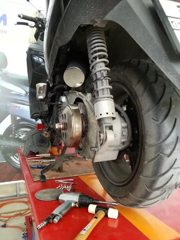

Not unless if you change to a higher tension spring so it will harness enough torque before releasing it to the clutch bell. :D Call me if you need any help!
Probably less likely since the clutch has a lock-up feature that prevents any slippage. Downside is u might experience a jerk wen d clutch suddenly engage. Can tune to ur liking using different springs though. But the basic workings of d clutch still d same. If u always go low speed n allow the clutch to slip n overheat, it will still glaze.
http://i1076.photobucket.com/albums/w456/ScooterNarcotics/543672_382788441759549_183858111652584_1021489_1466028451_n.jpg
Full servicing, Custom Jobs, Motorcycle/Scooter Check, Modifications & Paintjobs at the MOST competitive rate. 10 Kaki Bukit Road 1 #01-03
Call 86878551
Use higher tension spring on the stock clutch?
