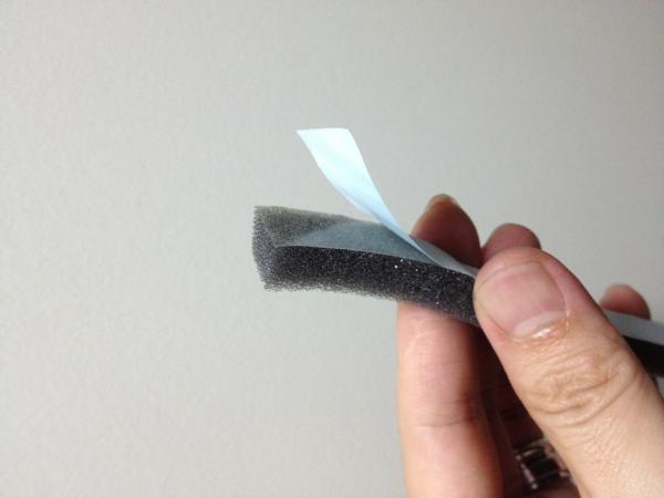

@duriandan- this is the weather strip I got from daiso which I used to kill the vibrations off the windshield and the garnish.

Kindly share where did you stick them at?

Did u mean sticking it between the windshield and the black V shape plastic?

Yup. I stick on the inside of the v shaped garnish. Will post a pic tomorrow.

So I wasn't the only 1 experiencing the annoying vibration from that area haha..I used some rubber and stuck it under the V black plastic..solved the vibrations for now.

$2 foam tape from Daiso: http://img.tapatalk.com/d/13/02/27/hu6u6eju.jpg
Stick along the long edge: http://img.tapatalk.com/d/13/02/27/aze8a3ud.jpghttp://img.tapatalk.com/d/13/02/27/qabajamy.jpg
And along the short edge: http://img.tapatalk.com/d/13/02/27/ujuteqe2.jpg
No more irritating buzzing!
