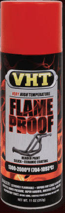

can0000flameproof.gifby the way VHT is the brand...
quote//
[h=2]VHT FLAMEPROOF™ COATING[/h]VHT FlameProof™ Coating will renew and extend the life of any surface exposed to extremely high temperatures. This unique coating is a matte finish, silicone ceramic base widely used by the automotive industry on exhaust systems and the aerospace industry for jet engines, re-entry vehicles and other high temperature applications. VHT FlameProof™ Coating will withstand temperatures up to 2000°F (1093°C) and is ideal for use on headers, exhaust systems, or wherever an extreme temperature coating is needed.
Temperature: 1300°F-2000°F (704°C-1093°C)
Applications: Headers, Exhaust Manifolds, Piston Domes, Inside Heads
Finish: Flat
Dry Time: Curing time required and can be done on or off vehicle (see below)
[h=3]Curing FlameProofâ„¢[/h]VHT FlameProofâ„¢ Coating only attains its unique properties after correct curing (refer to instructions on the can).
[h=3]On the Vehicle[/h]
  • Paint must be completely dry before curing
  • Run at idle for 10 minutes
  • Cool for 20 minutes
  • Run at idle for 20 minutes
  • Run under normal operating conditions for 30 minutes
[h=3]Off the Vehicle[/h]
  • Heat to 250°F (121°C) for 30 minutes
  • Cool for 30 minutes
  • Heat to 400°F (204°C) for 30 minutes
  • Heat to 650°F (343°C ) for 30 minutes
Caution: Do not exceed the temperature of the least heat tolerant component or the base metal

[ATTACH=CONFIG]251185[/ATTACH]by the way VHT is the brand...
quote//
Finish: Flat

Hi. This VHT Flameproof; is it available in Singapore?
Search all over Singapore and its not available, order mine online from Amazon, but Vpost does not deliver to Singapore. In the end I bought the Simoniz high temp paint from Mustaffa.

I see. Hoping that one day they will have a Singapore dealer for VHT Flameproof. Definitely can't get it from overseas, because aerosol products cannot be shipped out of the country. Unless you're an authorised distributor of course.
You can use rust oleum high heat spray paint. Available in Singapore. I used it for my rusted exhaust pipe. Waiting to see if it hold up nicely then i will post pics.

Performance Coatings International is the authorised distributor of VHT aerosol coatings.
http://www.vhtpaint.com/
We carry most of VHT products in stock. Our opening hours are from 9.30am - 6pm, only on weekdays. Cash term only.
Alternatively, you may wish to purchase directly from our online store. In-person pick up is free, but there's a small delivery charge, should you wish you have it couriered to you.
http://store.performancecoatings.com.sg/products/all?filter_brand=VHT&filter_industry=&filter_audience=
