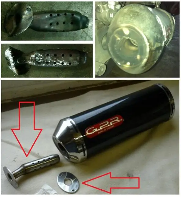

just curious, is there any possibility to buy or duplicate the GPR Exhaust Silencer for scooter SYM GTS 200. where can i get it ?
my exhaust silencer fly out and run over by a car.
if you have the silencer and the end cap, can i borrow for duplication ? or you can rent to me for duplication :-)
