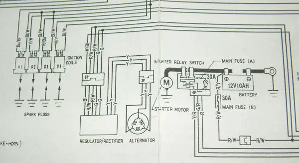

A mate of mine riding a 99 EFI upgraded his rr to one from a Hayabusa. It is a heavier duty one and is resistant to the dreaded fry. He run to Thailand regularly and uses the NSH like a short cut and has no problem since.
Me - i wire up a fan to my r/r for the stop and go traffic in Sg - tho it did not prevent the inevitable but perhaps prolong life a bit.
Is a Hayabusa R/R more robust than VFR's?
