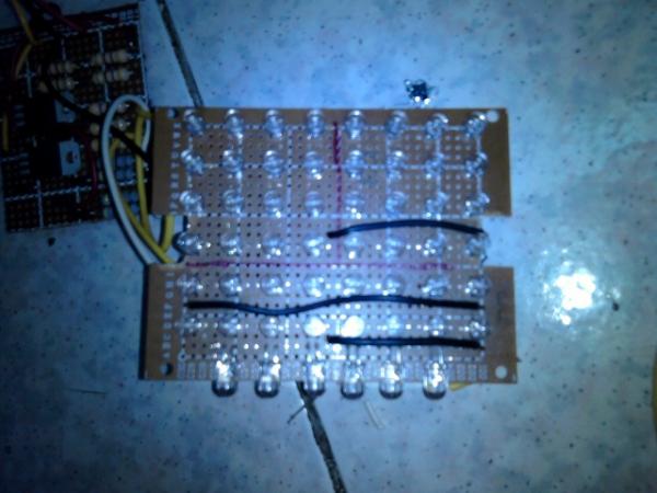

Right now i have trouble with the tail light, last week my battery died (yet again, it would be the 6th or so battery to die in just over 3 years) and when it died the voltage in the system spiked up to 24 Volts, killing some of the LED's in my tail light. Now i have to build a new one and am waiting for the LED's to arrive from Hong Kong (E-Bay). Another item unavailable in Thailand..... ultra-bright LED's. The new tail light will include a voltage regulator of it's own and spike protection - as it can be taken as granted that the new battery will be dead again in just over six months ("six months warranty" means "we guarantee that it will be broken in just a little over six months").

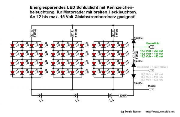

hi Thanh, how do you invent your led taillight? care to share? :thumb:
Hi :)

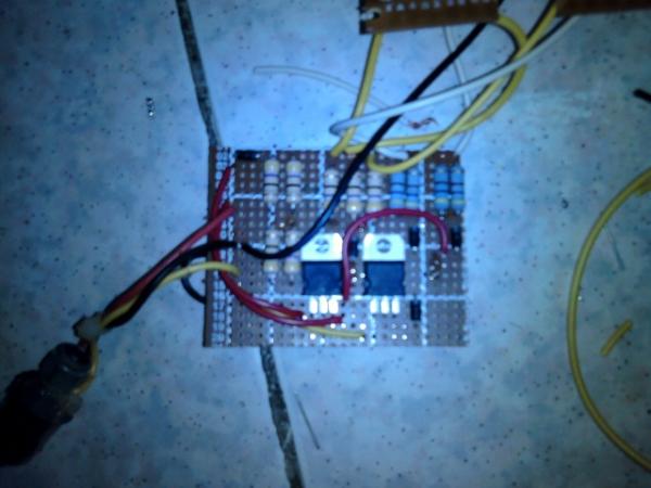

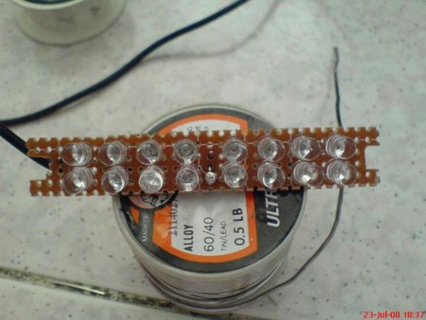

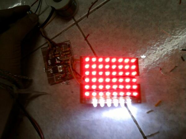

No problem to share that.... i am following loosely the schematics in the first picture, however i double the number of white LED's for license plate illumination and also now in the new one i have added two separate voltage regulators (for tail light circuit and brake light circuit, each one with a diode for back-current-protection) and in my test i found that even supplying it with 30 Volts does no damage, the LED's are supplied with rock-stable 11.5 Volts.
Of course my version is "more difficult than necessary" (specially with all the additional circuitry on a second, removable, board) however i have mine glued into the cover of a Japan-type tail light in such a way that it can only be removed by destruction..... and i want it to last for ever and not be taken out again when the next battery dies. And i need to glue it in there in such a way because i am doing 300 kilometers per week on some of the worst roads one can imagine.... Bangkok's Sukhumvit for example, one pothole after another..... without making it "bomb proof" with a pound of hot glue it would be breaking apart in a matter of days. Only the daughter board can be removed and fixed if required.

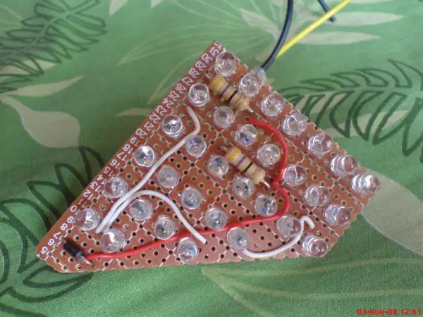

The good thing with LED's and this kind of prototype or experiment PCB boards is that you can put them into any shape that you like.... mine is for the Japan-type and hence a simple rectangle, however i have built my tail indicators just the same way and those are triangle shaped :) My meter illumination follows the same plan (all-white LED's) too.

PS one 47 Ohms resistor (the one between the two diodes) has to be replaced by a 2 watts version! Alternative you can also use 68 Ohms.

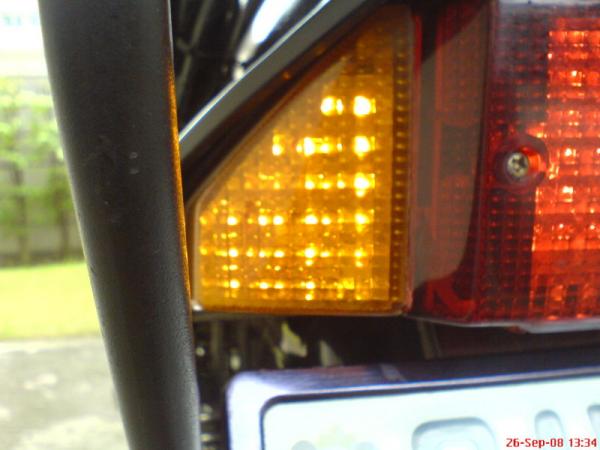

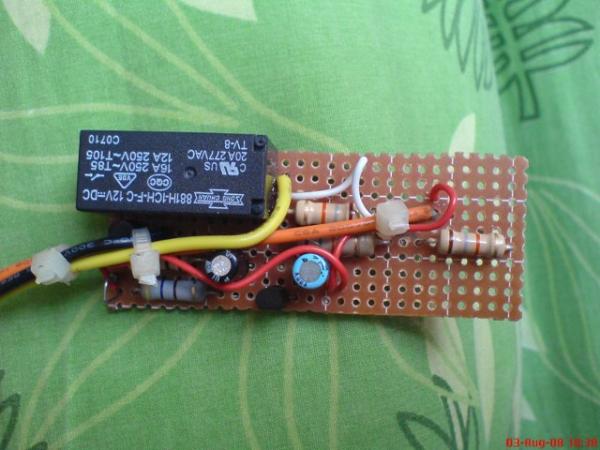

This is the setup for rear indicators for Japan-type RXZ. Please note that in reality these are a lot brighter than appears, it is because the camera automatically adjusted to brightness.....

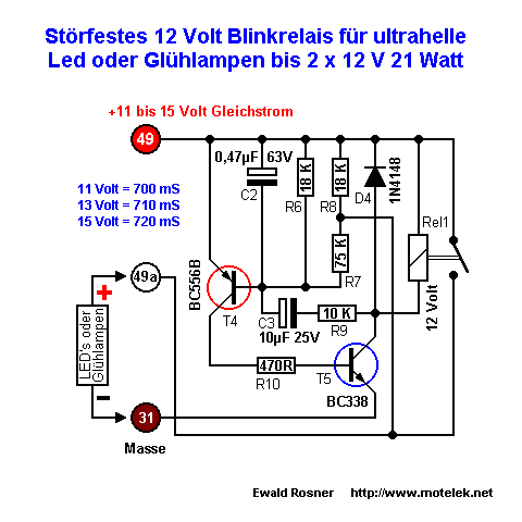

Also please not that, in order to run LED indicators, you MUST use an electronic relay. I built mine myself, too, following the schematics in that first picture :)

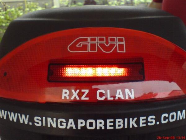

And finally, a stoplight for those "no stoplight" GIVI Micro-2 boxes :)
