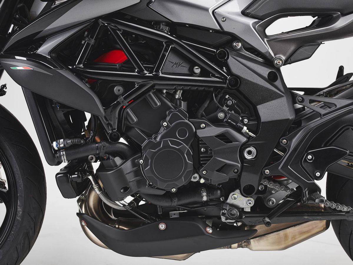

First the engine. Great attention has been applied to the reduction of all frictional losses. The sintered metal valve guides and DLC-treated inverted cup cam followers make the valve train more efficient. Equally, latest-generation plain bearings replace the previous ones with a solid gain in reliability and reduced frictional losses at the crank assembly. The lubrication circuitry has been modified, reducing the volume of lubricant, and a more efficient oil pump has been adopted resulting in reduced power absorption, a lower oil temperature, and a reduced oil splashing effect and its consequent drag effect.
The three-cylinder engine of the Brutale and Dragster has been refined to lessen frictional losses.MV Agusta
A new injection system bumps the pressure from 3.5 bar to 4 bar, for better atomization of the injected charge and consequently a more complete combustion and reduced emissions. The exhaust system, from the manifold to the catalytic converter to the three-pipe muffler, has been vastly redesigned with superior efficiency of the catalyzer. A solid increase in the profile of the torque curve has been achieved: MV Agusta announces a peak power of 140 hp at 12,300 rpm and a very remarkable 64.2 pound-feet peak torque at 10,250 rpm. The torque curve appears very strong from 4,000 rpm where 50 pound-feet are already available, and from there the curve goes constantly up with no dips.

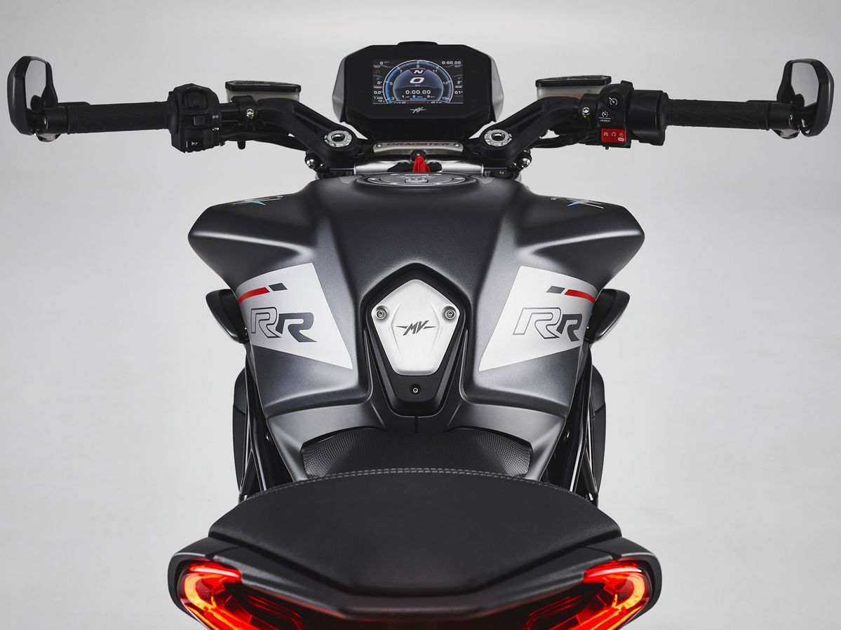

A new, 5.5-inch TFT instrumentation display acts as the command post of connectivity functions included in the electronics suite that includes a navigation system, Bluetooth, and all connections with the MV Ride App. The app lets the rider talk to the bike to set up preferences, record trips, add enhancements to the navigation system, and more.

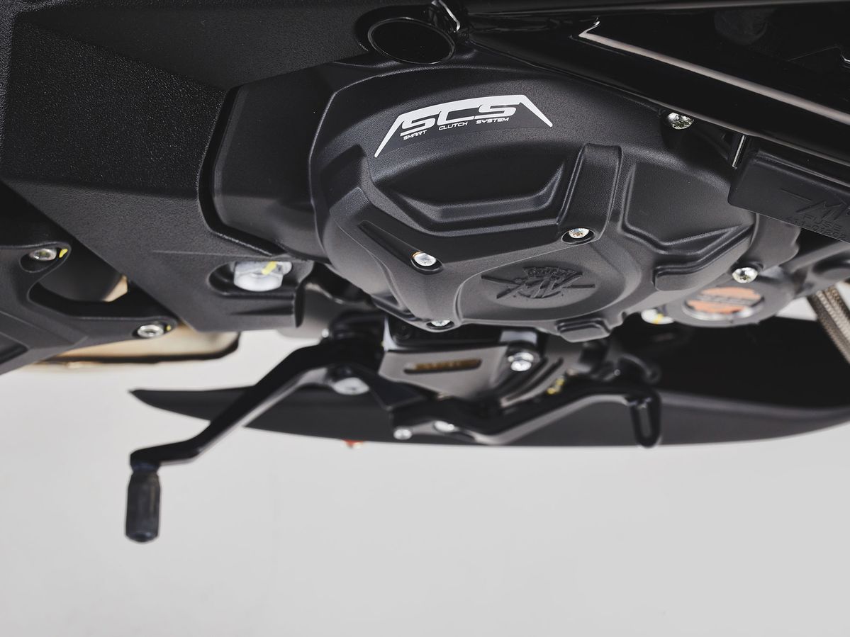

Gillen worked with American clutch component company Rekluse to further optimize the Smart Clutch System. The fully automatic mechanical clutch makes the rider’s life less crowded relieving them from pulling and releasing the related lever on the left side of the handlebar. The SCS system positively integrates the EAS 3.0 electronically assisted gearbox that has been further refined thanks to the adoption of a new sensor that makes it quicker and more precise up- and downshifting.
The frame of the MV Agusta three-cylinder models has been highly respected from the beginning and now has been revised in its rear section where new and more massive aluminum plates replace the previous ones in their fundamental function of solidly clamping the engine and locating the rear swingarm spindle. The new plates improve both the torsional and the flexural rigidity of the chassis that also received new and retuned suspension units. The 43mm Marzocchi fork and gas-charged Sachs shock absorber are both fully adjustable. Also the link actuating the rear shock absorber has been revised in its geometrical progression.

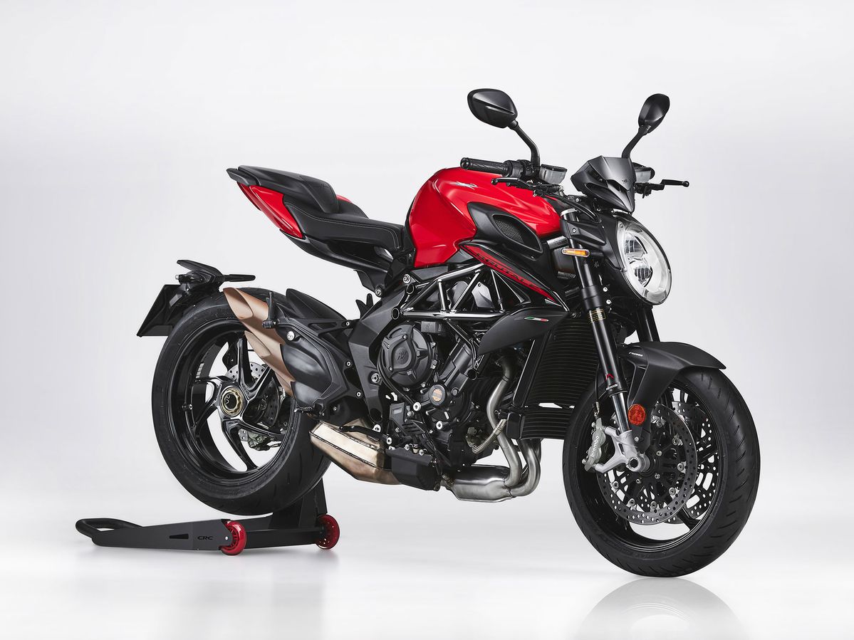

The MV Agusta Brutale comes in RR and RR SCS versions both fully equipped as described above. The starker Rosso version is powered by the 112 hp at 11,000 rpm version of the 800cc MV triple. That is the only major difference, the rest is all there for a nicely milder and more accessible Brutale 800.

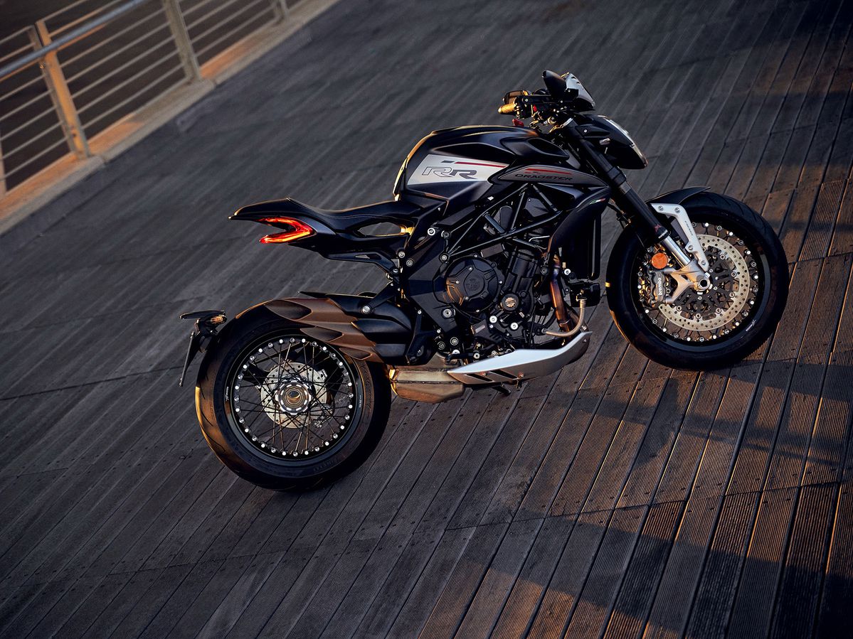

The MV Agusta Dragster adds style and spirit to the already capable Brutale platform.MV Agusta
The Dragster 800 is a Brutale pushed to the limits in terms of styling and spirit. But it shares all the mechanical and electronics refinements that were painstakingly developed in the latest iteration. The new Dragster comes in four editions: RR, RR SCS, RR SCS RC, and Rosso. The Dragster RR and RR SCS both feature beautiful wire wheels that make them even more distinctive given the rear wheel is fully exposed, enhancing the muscularity of the new 200/55-17 Pirelli Diablo Rosso III that features a more progressive profile compared to the one adopted on the previous MV Agusta Dragster.

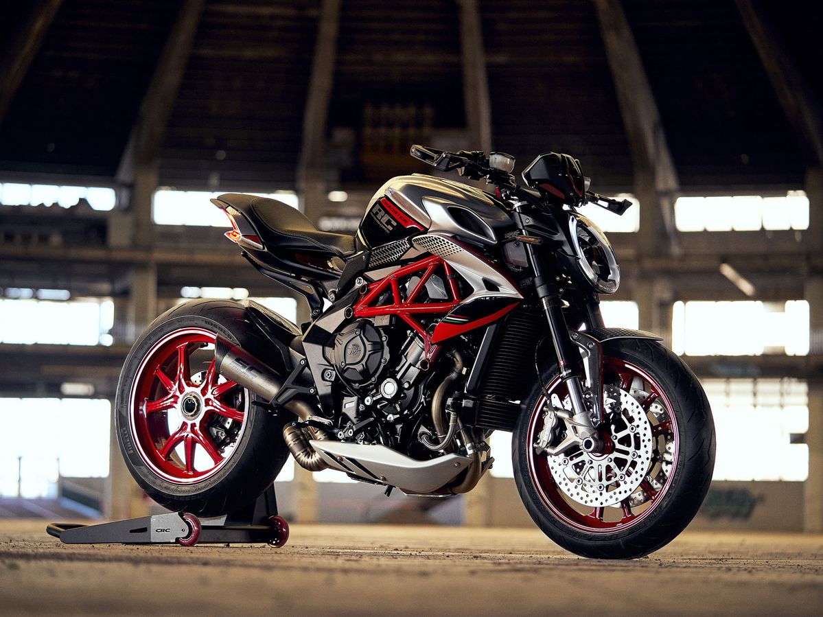

The Dragster RR SCS RC is a more extreme version that will be available in 200 numbered units and that features distinctive graphics with a bright red frame and bright red forged aluminum wheels. In addition, a “racing kit” is available exclusively for the RR SCS RC and that includes a free-flowing exhaust system and related maps, for the addition of an undisclosed number of horses and of an extra dose of adrenaline induced by the aggressive exhaust note.
