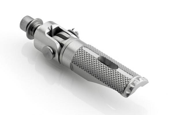

Yo bro, they are correct that they have no folding pegs...
the adaptor that i'm using is PE606A. it is spring loaded and will always return to the opened position...
and it can also be locked to make it rigid in the opened position, as in no folding but it can't be locked in the closed position.
hope this helps. :)

U r most welcome :)
Btw, if u want to get complete with peg like the 2nd photo, it's PE608A (the last alphabet denotes the color)
