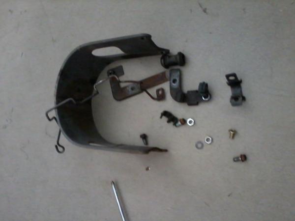

Took off a load of crap at the front end too

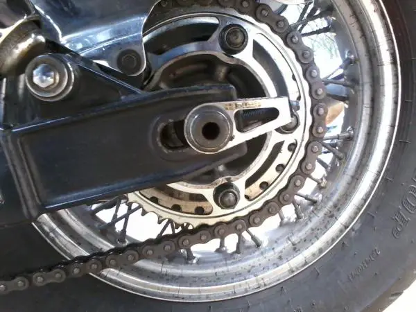

My personal account of changing to a smaller rear sprocket
I have been reading overseas shadow ace 750cc forum and they have been giving good feedbacks on a smaller rear sprocket modification 38tooth from the original 41tooth.
Since the modification allowed me to use a 120 525 links chain(commonly used for a super four ; giving me a wider, cheaper range of chains) instead of a 122 link and I was due to a chain change, for shits and giggles, since it was never spoken here in our forum, i went ahead to order it online. Despite mine being a 400cc.
Mechanic said it will give me less power and its not a good mod for a 400cc. Climbing up carparks will be hard.
I am stubborn and ordered it anyway. As by ratio, the change was minimal.
I bought a chain and it was on the way on freight but its taking too long! But waiting for it means my mods are reversible!
I was impatient and since i was at the mechanic, i had him to it.
I watched as he grinded off two links and when he took off the sprocket, it was 43 TOOTH!
Siao liao :sian:
Riding off, bike keeps stalling when clutching in so i had to increase the idling.
As I hit the first gear, it seems 10-15% slower than normal but the taller gearing meant that i could drag it longer. So its not something too much of a difference.
Second gear was the same as the first.
But once it hit 40km/hour, OMG! You need less rpm to increase your speed!Its really obvious!
I shifted too early and at 60 at the last gear, it gave that draggy wrong gear feeling. However, at 70, it felt right.
I found myself moderating well at the highway from 90-120km/hr.
It no longer gives that finding the last gear feeling.
Its a really nice smooth cruising experience now.
This is a great mod and i strongly reccomend it.
I will never change back to the stock 43t gearing.
This really feels right and is the best mod i have ever done to my shadow.
I will update this again with the fc and the multi storey carpark climbing abilities.
