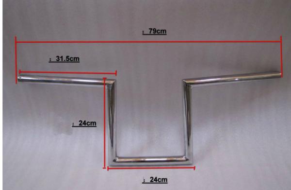

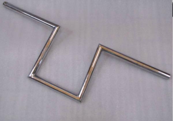

Brand NEW !! Bobber/Chopper handlebars for all type cruiser
suitable for Harley, honda shadow, steed and yamaha dragstar as long riser is for 25mm diameter .
viewing at 619 hougang ave 8 .
selling @ $99

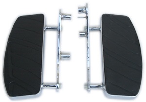

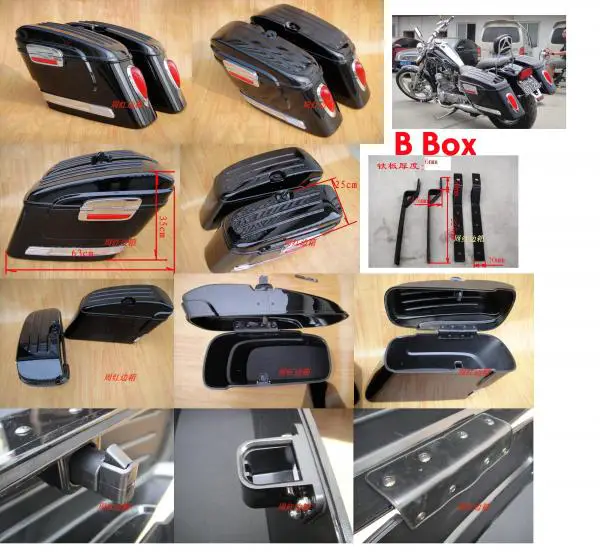

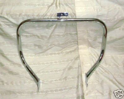

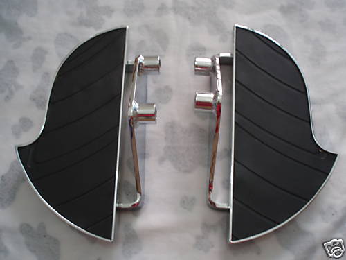

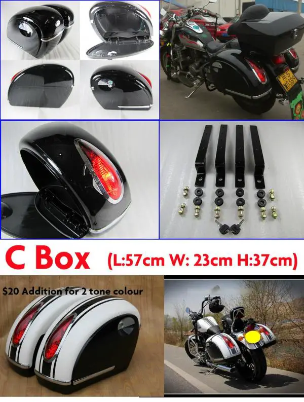

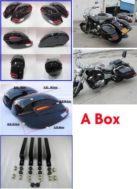

Hi im gonna have mass order and close by sunday night.
think u can catch up with my shipment.
do pm me for more items u needed
highway bar $70
honda shadow flood board (front) $85
honda shadow flood board curve (front) $95
box A :Pm price
box B :Pm price
box C :Pm price
Front Footboard2 97-03 .JPGfront Footboard 1 97-03.JPGshadow crash bar 97-03.jpg
