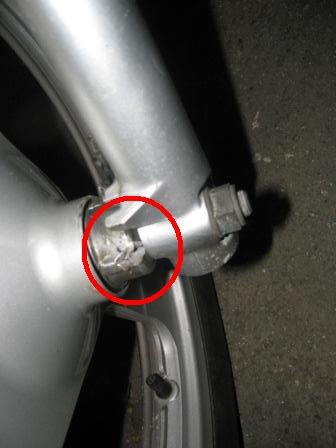

Hi guys,
Need help with the bike. Was overseas for long time. Missed riding very much. When tried to ride forgot to unlock the metal chain I put on a front wheel for security reasons. When stopped found out that the cable/spring was torn. Now speedometer doesn't show how fast I'm going. Also there is some crack on the wheel, photo attached.
Is it dangerous to ride with such crack? How much will it be to repair it?
