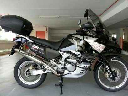

BIKE SOLD
Hi
Selling on behalf of my bro.
COE till- July 2019
Rd tax expire - 29 Jan 2014
Come with
2 months 55ltr Hepco & Becker.
Hepco & Becker crash bar.
Givi side rack without box & windshield.
BMW grip & front beak.
Arrow legal end can. Original will give to buyer together with Arrow Drakkar straight header
Scotoiler.
New rectifier, starter relay, rear sprocket, front tire(Michellin Anakess).
Will give away all used working parts (including tire with half thread)stated above to buyer.
New front fork oil and front brake kit.
Superb engine condition(hear to belief it). Only use Motul V300 engine oil 15w50 fully syn and oil change at interval of every 3000km.
Bike seldom use as owner drive to work.
Asking 9.5k nego.
For enquiry call 92780851
Edited by Doblair
