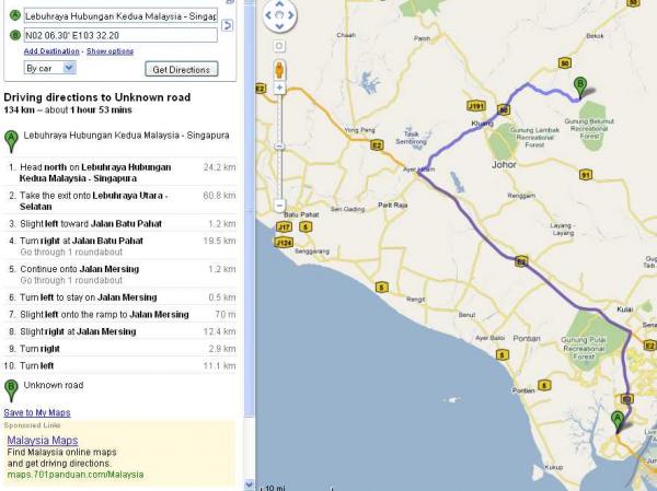

So where do we head for next ride? I think most of us can afford short trip only. unless planned in advance.....
I was thinking of going splashing in the water in this hot weather. Probably go up to Belumut Waterfall.
http://www.waterfallsofmalaysia.com/100yong.php
Time and date You all decide ah
