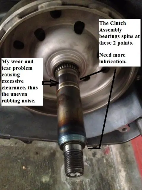

Yeah. need pay more attention to this shaft and the clutch assembly bearings during maintenance.

[ATTACH=CONFIG]246855[/ATTACH]
Manual says put 22-28g of grease in the clutch assembly hole that is in contact with this shaft. That is quite a lot of grease. Did a full disassembly and relube of the clutch assembly today.
The discoloration end is the part where the shaft is resting on the belt cover bearing. Check the condition of the bearing in the belt cover. Inspect if it is seize up?
The shaft doesn't rest on the case bearing but rather the clutch assembly rest on the case bearing. It's hard to lube unless you remove the bearing with a bearing puller. Anyone has it?
