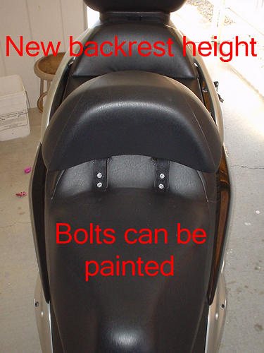

I copycat-ed this when I had the SWiNg. It is so comfortable when riding long distance.
lol, shall try it when i get a silverwing at the end of the year.
