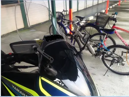

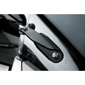

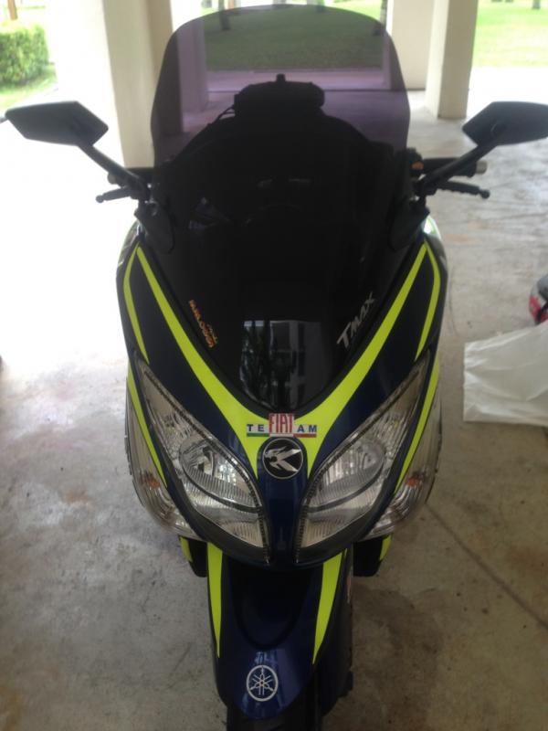

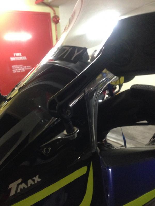

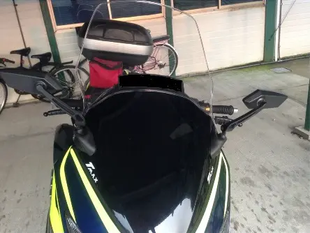

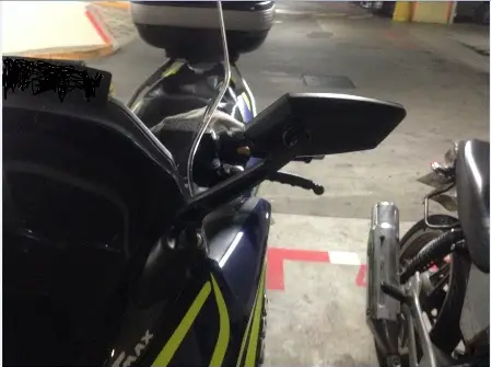

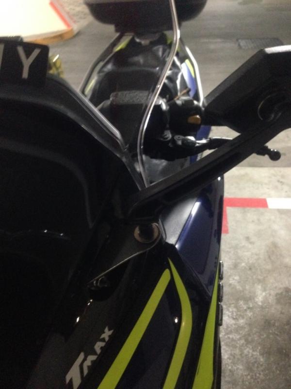

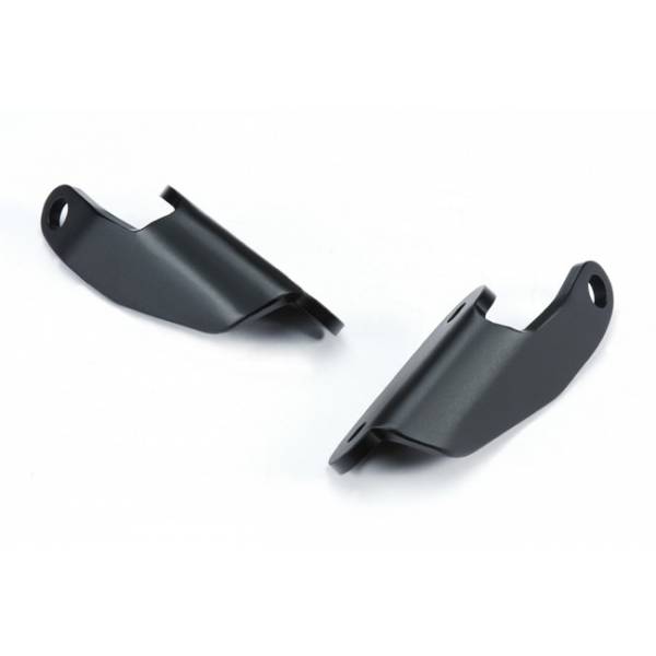

Hi Guys, I innovate our OEM Stock wing mirrors which is tall to something, I saw in the web. Do some own brackets nearly same that selling on the net and then fix Koso mirrors, makes a lot lower and cosmetic change just to share with others. de-pretto-moto-mirror-adapters-for-yamaha-t-max-500-08-11 a.jpgde-pretto-moto-mirror-adapters-for-yamaha-t-max-500-08-11 b.jpgde-pretto-moto-mirror-adapters-for-yamaha-t-max-500-08-11.jpgTMax with Koso Mirror LH.jpgTMax with Koso Mirror LH (640x400).jpgTMax with Koso Mirror RH (640x400).jpg

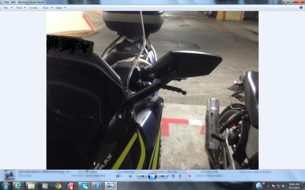

One thing is the brackets from the one selling in the web is thick and cannot use back the OEM mirrors rubber boots as I removed them and fixed to my homemade brackets, so rainwater don't seep in and wet the electricals inside the headcowl area - have battery, HID ballast, Power Commander , loud horns etc inside la
Edited by mdjjz

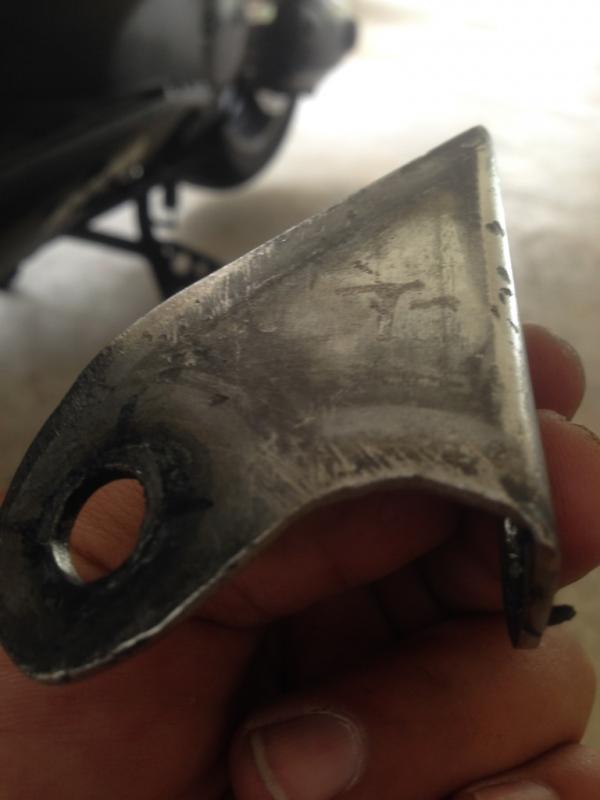

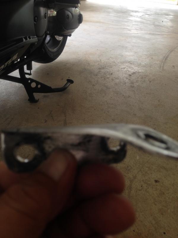

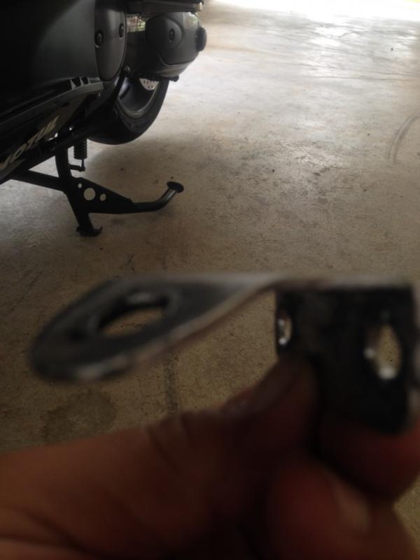

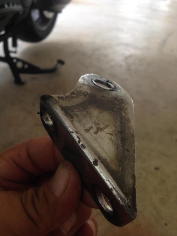

hi bro bobktm2, actually I copy the design and own fabricate them la bro, not where to get as not sold anywhere else, a bit technical handed during my free time, draw, cut, drilled holes, grinding SS plate etc about 14 manhours - IMG_3877.jpgIMG_3878.jpg

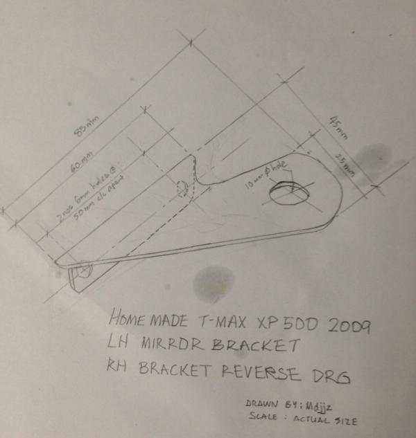

Guys, own homemade bracket drawing for reference only, Not for mass market reproduction or sales. For myself own use only and TMaxers guide only. Please make
sure you slotted the 6mm holes for tolerance and adjustment for fitting, missed out the height at the L bend is 15mm height IMG_3890.jpg
Edited by mdjjz
