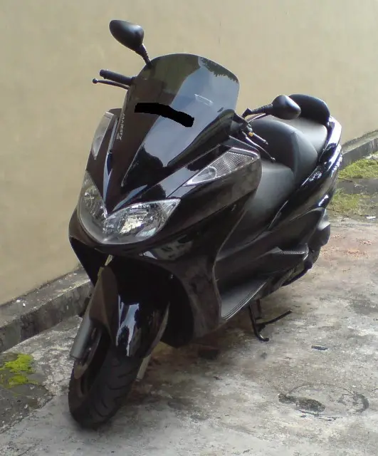

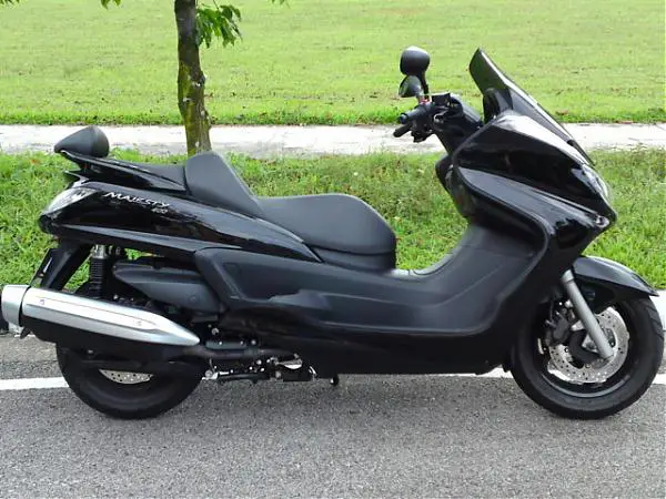

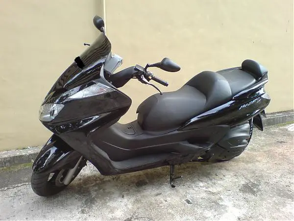

Hi Majesty Lover! just to share some photos of my black majesty.
Black is Nice!...
Been sometime did not log to this forum.....Majesty riders no more no less..haha
