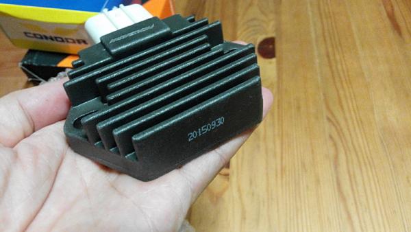

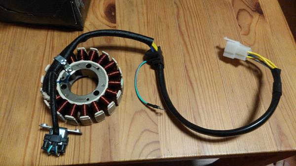

Hi fellow Twister and Titan riders! Recently I also encountered the "no parts" situation from the wonderful Boon Siew parts support (or lack thereof). A voice over the phone said that I may need to wait 1 year or 2 years for my part. I took all my self control to keep my vulgarities in check.
Anyway, to cut the long story short, I started searching for online parts store to get my parts. After sending quite a few emails, I found an online parts store in Brazil that was very helpful. Here is the website:
Masada
http://www.masada.com.br/
Email:
contato@masada.com.br
I ordered about $300+ worth of parts including the Stator, Ignition Coil, Rectifier and even the CDI among others (these are OEM parts, but they work). For some reason (they said "conference" and it meant checking the parts. My guess is that they probably had to order from the supplier?), they took about 2 weeks before shipping the parts (received the tracking number). After that another 2 weeks for the parts to come. I chose express shipping ($135 or something depends on weight). Normal shipping will take about 20 days they said but cost less.
Throughout the wait, communication from the support staff was very good and emails were replied promptly (factoring the 12-13hrs time difference). The 2 persons I communicated with were Isadora Medina and Eduardo Saldanha. Their English were excellent. Isadora was also very apologetic throughout the shipping delay.
The way I do it was as follows:
1) Type in CBX250 in the search box and see what items I wanted OR use google translate to figure out the Portuguese equivalent of the part (eg Stator = Estator, Cable = Cabo etc...can learn some Portuguese along the way)
2) Copy their http links and paste it into an email with description
3) State number of units I wanted
4) Asked for total costs plus shipping
5) Once I confirmed with them the order, they will send an invoice to my Paypal account in Brazilian Real which I can then pay using SGD using Paypal
The CBX250 and the CG125 Titan are fantastic bikes which Boon Siew SG has let down in the area of support.
Now, we have an avenue to find our parts!
Hope that this helps the fellow riders out there!
Cheers!

Yup, I called around but they have no charging coil either.
My bike is having some electrical problems and I bought these parts since I might as well get all of them in one go.
