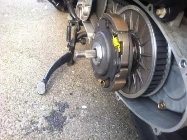

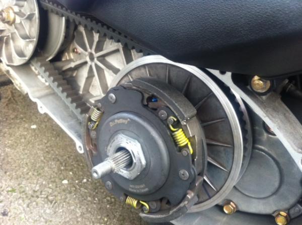

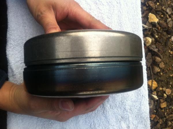

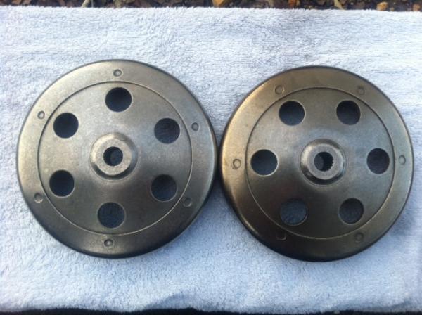

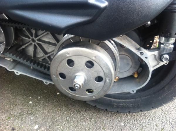

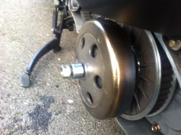

Here are some pics of the Dr. Pulley clutch mounted on my bike, the state of my previous clutch bell and a comparison with the replacement.
Old bell burnt:
Compared with a new Kymco bell:
State of clutch pads after only 1 week of use with old bell:
Clean pads:
New bell mounted:
