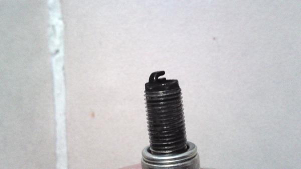

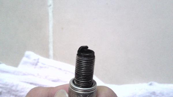

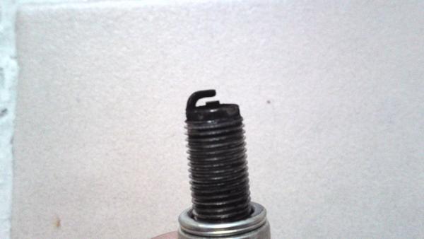

bro yoshi, i need some advice from you...
base on the plugs, what do you think? my carbs just serviced ard 3mths ago.
i think i'm running too rich, 4-5k rpm sound watery, is that what you mean by air/fuel ratio?
& my FC is higher recently. i dont want to waste my $ as i asked few shops, they only said
"put your bike here, i service your carbs then see how"
They're look dark and wet to me; not a good sign.
You're running rich, that could explain your poor fuel consumption. It's got nothing to do with servicing your carburetors, were your jets changed before? If so, you may need one size smaller main jets.

bro, i just change the floats + service for $600+... main jets in carbs? but i should have changed to oem. will tunning the carb help? it just happen recently. when i first got bk my bike, it had a better mileage... out of 4 plugs, 3 were like that, 1 was fine.
& this, actually last week i was going to bikeshop becos of this problem but 1/2way @ highway, its back to normal. everything totally back to normal. few days back, it came back. really giving me a headache...
Tuning wouldn't help if your jets are wrong to start with.
Would be helpful if you can check if all the jets in your carburetors are the same? It would seem strange that only 3 of the 4 cylinders turn out like that. Something is definitely different in that 3 cylinders that isn't in the 4th cylinder.
Does it happen at low speed or high speeds?
now normal riding is abit watery only @ 4-6k rpm. all of a sudden like after i change eo, the bike can totally sound like fug. unresponsive @ all. haha, i'm goona breakdown. it can still go till 120kmp but i think i need to throttle more to hit 120. ideling (dont know how to spell)also unstable.

that's why. erm, ok. 4k-6k rpm, sound "lao hong", like lost power. & if i'm not wrong, even when i'm otr holding my throttle, can hear coughing as in petrol going not smooth. weight of eo? is it this, 10wXX, i forgot the last 2numbers... should can confirm its running rich as i can smell serious petrol smell from exhaust. only thing now is how to troubleshoot the problem. a friend of me told me maybe its the intake tube... 1 mech said float overflow. i guess the only way is to take out the carbs again. maybe this sat go bikeshop.. Edited by ben2306
