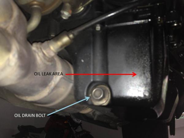

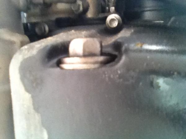

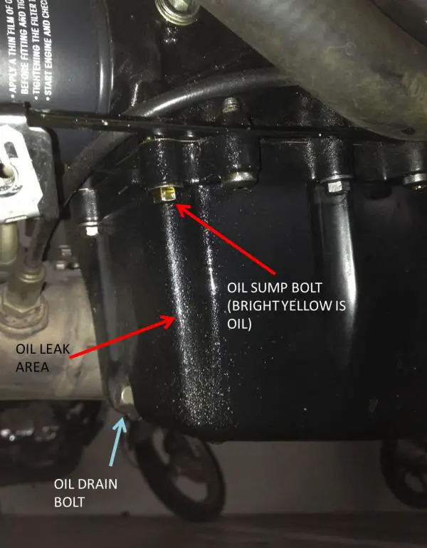

Hi everyone. I'm currently riding '13 streety. Just want to ask fellow streety, particularly '13 model.
1) Do you experience any oil leak? Usually the base of the oil sump is wet with engine oil (yes, EO, not chain lube).
2) I notice upon inspection, the front bolt at the oil sump (on the right side of oil drain bolt) is loose. Anyone had the same experience? I torque it to spec (12Nm) but still no difference.
Went to MAH the first time, was told maybe due to chain lube but after i did a thorough cleaning, the oil came back. Usually after a ride. Will post some pics when free.

im riding the 13 too but didnt experience on this issue.. try the triumph675 forum or street triple uk forum maybe they can answer ur doubts
A couple of triumphrats and street-triple.co.uk forumers having the same problem. But i understand that assembly and make is different between us and them? Just wana know if anyone here is also affected.
The picture above is the base of oil sump. Almost completely wet with oil. No drips though. Just wet when you touch at the base.
that looks like a worn gasket, correct if im wrong new str 13 are assemble in thailand, so hence quality issues.. i guess so.. do approach gary as he is the one in charge of triumph warranty.. remember must push them as i am also claiming warranty on my front wheels..btw im coming down this fri to clarify with them on my wheels and the known str 13 rear subframe chaffing with the seat staples. U can meet me there or pm me ur hp no.
