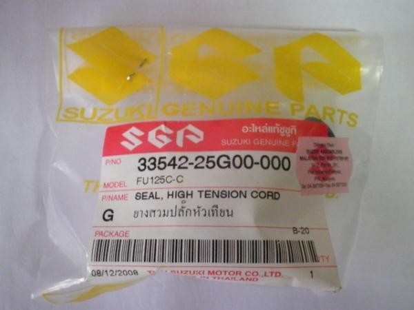

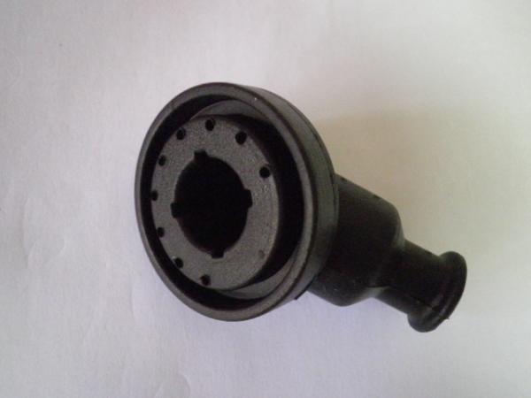

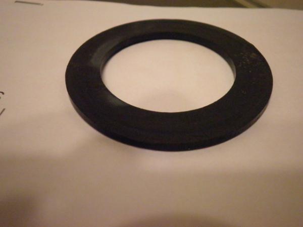

RM 1 changed fuel rubber tank lid
changed seal cap high tension cord
checked water in carburator by opening the screw. NO water

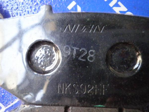

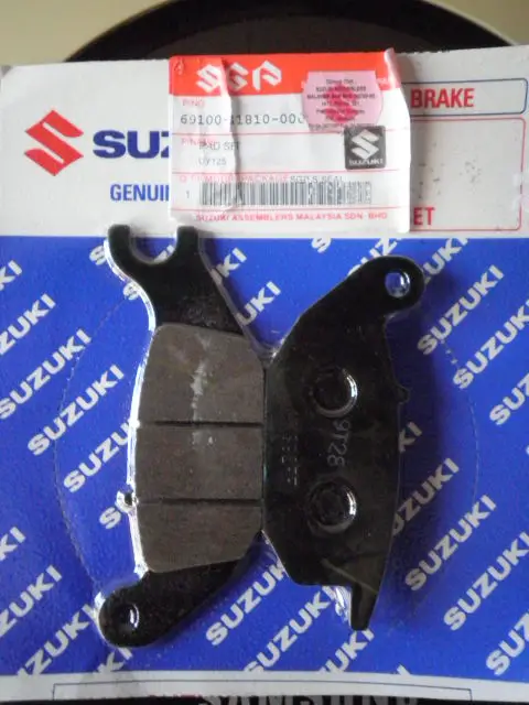

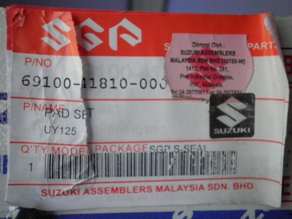

Suzuki genuine NISIN brake pad for rear caliper

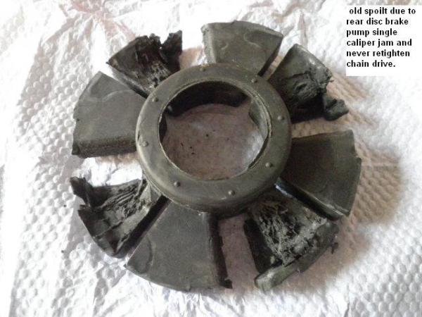

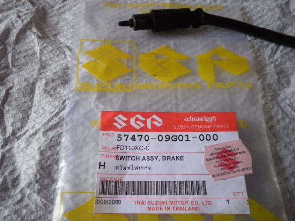

Rear disc brake pump jam . Service pump.
Mobil 1 brake fluid DOT 4 100%
Front disc brake release air. Now smooth braking
Still on shell DOT 4
Shock hub RM4 rear wheel .
Switch ASSY brake i.e. Clutch pull during start electric. That switch malfunction – spring problem. RM8.70 modify FD110 with FU150

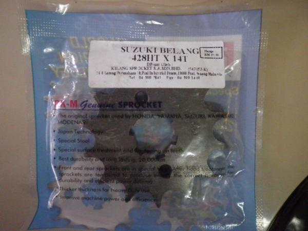

changed :-
RKM chain drive set 14T , 42T (original is 43T) , Heavy duty chain RM65
Front sprocket clip
Front fork oil change ELF 103.5cc each fork
Brake fluid Mobil 1 front disc caliper only
SHell advance vsx semi-synthetic Engine oil + oil filter
Labour RM20
take note
original rear is 43t
but now I put in 42 t
less vibration and more drag
