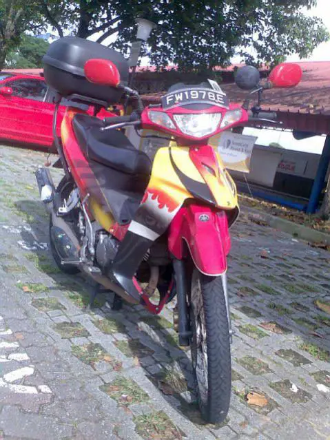

I spray lacquer only on the top coat and once everything "baked" nicely under the sun, a layer of turtle wax for durability.
I sprayed my 125z in 2006 and it looked exactly the same in 2010 :3
All colours and clearcoat were RJ London.
This type of custom design would cost you like $850 if done in shop. DIY = $50 inclusive of friend's makan + supplies :3
Other methods may differ but I know mine works.

[ATTACH=CONFIG]204480[/ATTACH]
