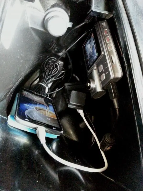

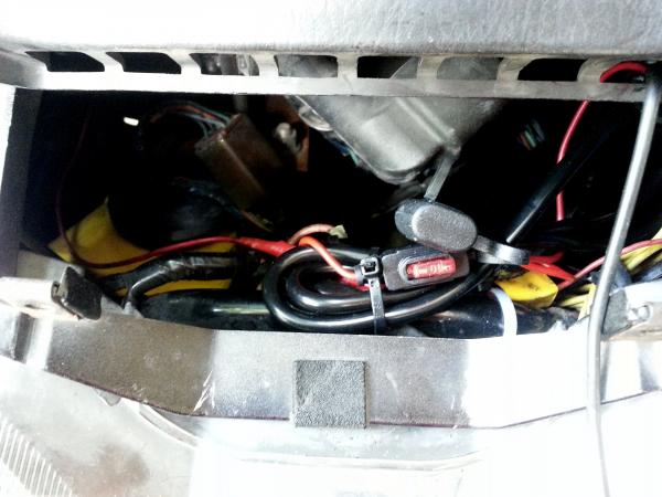

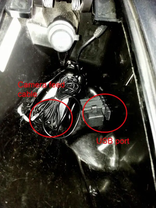

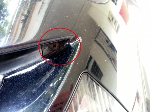

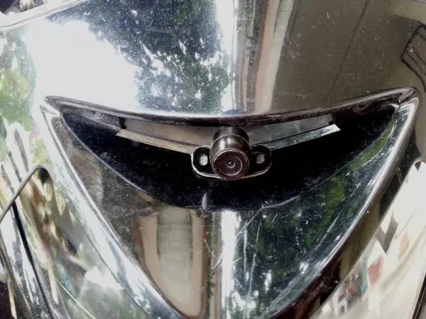

I don't like the idea of riding without a camera and previously was using gopro mounted on handlebar and helmet but they have their limitation. Short battery life, Require user to turn on and off(no automation), mounted on helmet looking like teletubbies and its heavy/bad aerodynamic, risk of theft if you forget to remove from your bike.
So I bought a dual channel car DVR camera with waterproof lens and decided to install it today.
There is a 12V ciggy socket in the left tupperware which i could use but it is wired to be on regardless if your ignition is on/off which runs the risk of depleting your battery if your forgot to remove whatever you are charging. I could rewire the 12V ciggy socket but I have to remove the front cowling.
I choose to leave the 12v ciggy alone and install a 12V dual port USB charger in the left glove compartment. Wired to ignition, it will power my DVR camera and other devices when bike is powered on and will stop charging when bike is powered off.

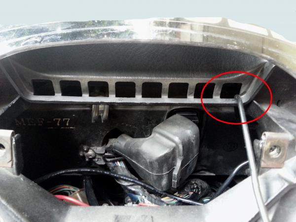

First. Remove the two phillip screws above the headlight and 2 phillip screw at both ends of the dashboard. Gently nudge and remove the cover about the headlight.

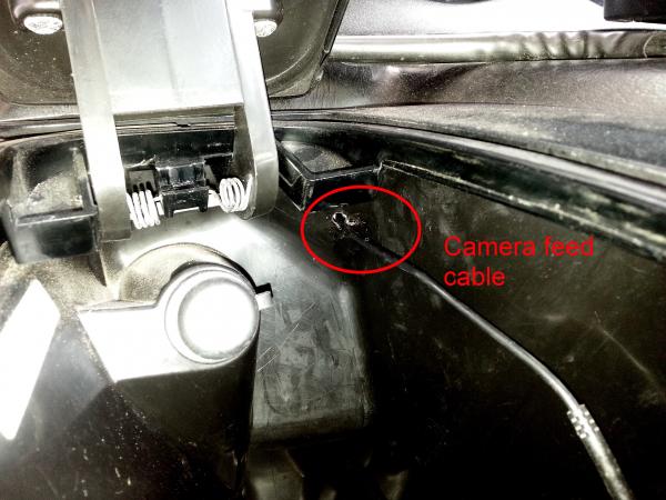

I am going to install the camera and charging port in the left glove compartment. There is a default cable opening at the bottom right. yeaa, no drilling needed for the power supply cable. However to route the camera feed cable through i would have to drill a small hole at the top right corner.

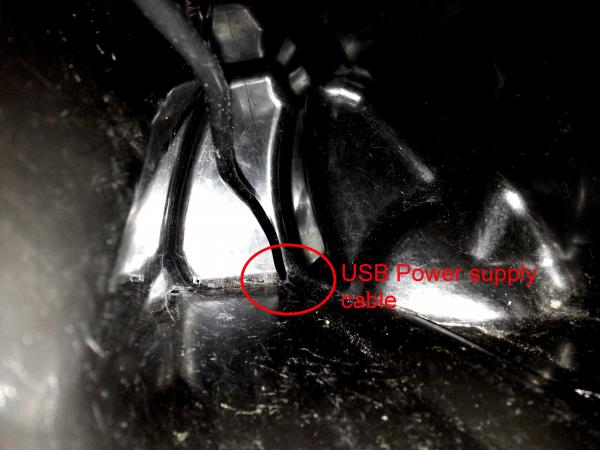

Once the camera feed cable opening is done you can proceed to remove the cable and routed it through this vents and back into the back of the left glove compartment.

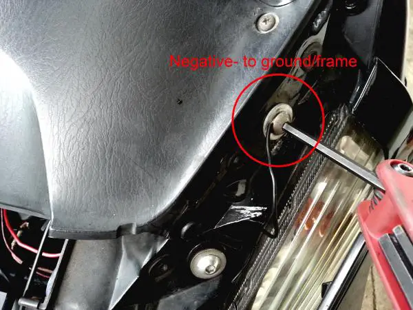

After routing the power supply cable from the back of the glove compartment to above the headlight covers. I then splice the cables and remember. Red- to hot live. Black+ to cool ground. Also added a inline 10amp fuse.
Adjust the length of cable needed from the glove compartment and tie down all the loose wire at the front.
Camera feed cable is extremely long(This was meant for car) so i had to tie it up at the bottom of the glove compartment.
Remember to do a pre ride test to ensure all is running fine.Will probably fabricate some sort of mini acrylic shelf so the cables etc are at the bottom and I can place my phone on the upper level.
This is how it looks. Rather obscure. Please pardon my dirty bike. hehe
This camera runs dual channel which means I can install a rear camera but I will leave that for another day when i am free.

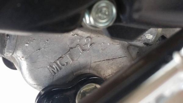

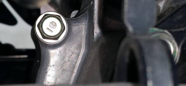

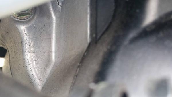

Hi All, i notice multiple "cracks" on my 3 mth old silverwing 400 engine. Its the area around the main stand bolts, any one has the same issues? And anyone knows if this is normal? Thanks for the help.
11864838_10152967950401536_7002640178214266127_o.jpg11921758_10152967950566536_8074762634664221620_o.jpg11896114_10152967950661536_3182281067104755182_n.jpg11953001_10152967950761536_8584479239671115496_n.jpg11896069_10152967950816536_8124284302940101389_n.jpg

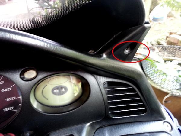

On the FJS/JDM ... centre on top of top cover (there're 2 screws), e.g. using a RAM ball for mounting GPS/Phone holder, strong enough as hook too
http://i692.photobucket.com/albums/vv287/josephsbs/Silverwing/RAMcentre.jpg
On BOTH FJS/JDM and SWT/GT ... side/left handlebar using the 2 screws holding the left brake reservoir assembly, e.g. using a RAM ball for mounting GPS/Phone holder, strong enough as hook too
http://i692.photobucket.com/albums/vv287/josephsbs/Silverwing/RAMside2.jpg

FJS / SWT are fitted with standard "load-based" electro-mechanical flasher relay that is used with BAU15S signal bulbs. When changing the signal bulbs to LED, it will cause the LED to blink faster than the standard 1 flash/sec rate. It's needed to convert the flasher relay to the electronic / solid state type. The relay is sourced by @MaIkEr :thumb:
For FJS, the orginal relay is mounted on the instrument cluster. SWT uses standard DOT connectors and are located somewhere inside the front crowling. @MaIkEr will know and update :) Below steps are for FJS.
This is great and helpful information. I have three questions: 1) Will changing to an electronic / solid state flasher relay work if only the rear turn signal bulbs are changed to LEDs while the front bulbs remain standard? 2)Will adding this electronic flasher relay still allow the turn signal indicators on the dashboard to operate? 3) Which manufacturer makes this solid state relay and what is the stock number for the relay.
Thank you for your response.
Tim
the electronic solid state relay will work with ANY combination of LED vs incandescent bulbs because it only takes a minute current to activate. the convention relay being mechanical, requires more current and Might not work with LEDs. I am currently running both bulbs combination with the LED relay on my ride.
so answer to Q1&Q2 is yes.
Q3: eBay has them, 2-Pin 12V Electronic LED Flasher . PM me if u need them in a rush. I have a spare set available for $10 with a 100% refund if you are not satisfied with it.
