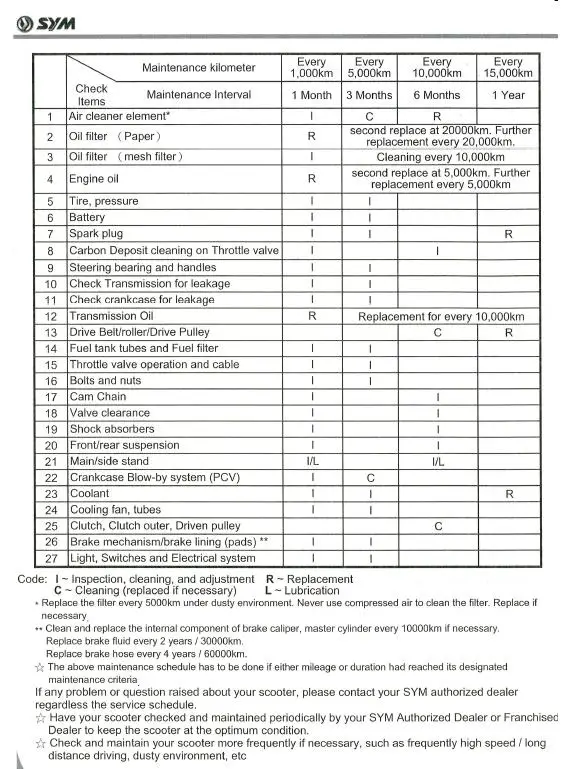

Ok,so thats e eo filter.e one with SYM wording,3 allenkey mounting..noted with thanks..change it every oil change right...
Engine oil filter(paper type) replace at first service - 1000km , second replace at 20000km and later every 20000km:thumb:
as the man say. base on manual.
every 20K km.
i would change every 2oil change.

About the gear oil
Manual says 85W-140, but i ask more than 10 shops and they all don't have this spect.
I also noticed Mah use a 80W-90 castrol gear oill for the servicing, is it ok to do so?
Better stick with the factory spec. Don't mind the number before the W just the 140.
You can use 70W140, 75W140, 80W140, 85W140 and etc
There is a reason why SYM is using such a thick oil. To cushion the gears, noise, due to extreme pressure, due to very high temperature.
Thinner oil will not be able to cushion properly during high torque and higher speed will fling the oil away from the gears, high pressure, high heat. Wrong oil may chew your gears in time to come. Not now but don't know when either :p
?W-140 are gear oil usually used in heavy duty vehicle.

85w-140 oil so far only one brand has it..its royal purple...i also dont know where to get it..lol
Mah do the servicing for me for the gear oil..so far so good :thumb:
p/s I change gear oil @ Mah at 1500km now i alrdy at 3700km..hehee

EO got alot of Brand bro with different prices:
1) Maxima 10w-40 - $22/Bottle/liter (Recommended by SW9000)
2) Motul 10w-40 - +/- $25/Bottle/Liter (Some say Motul oil is alil bit heavy)
3) Mobil 1 - $23/Bottle/Liter (Recommended by Me..heheh)
4) Caltex 10w-40 - $18/Bottle/Liter (Iam using this now; its not as good as Mobli1 i previously used)
5) OWS 10-40 - $29/Liter/Bottle (Used this on my SW previously, super smooth but alil but expensive)
FOr Gear oil got alot of brands, but i not too sure the performance of it. The only thing i know is that last time i service my SW using OWS Gear Oil..to be honest u dont feel any diff..

Went to autobac just to look-look see-see and found this info,so just sharing with u all maxsym riders out there...
Zero SP 80w-140-$51/ltr
Motul 75w-140-$48/ltr
Ows 85w-140LS-$55/ltr
Redline 75w-140-$20.50/quart~0.946ltr
Liquimoly 75w-140-$72/ltr
Castrol 75w-140 $55/ltr
