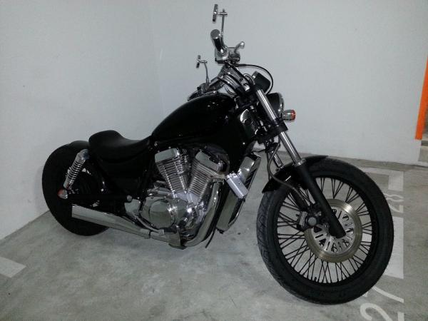

Oh...must reduce image size first before it works! But then it becomes a little too small to see. Now trying again with a slightly larger image...
[ATTACH=CONFIG]316967[/ATTACH]
2 thumbs & 2 toes up for bike bro. Damn swee..
BTW where you send your bike for this restoration? I just got myself a rundown intruder400 myself & she need to be restored.
Don't mind pm me details bro :)
