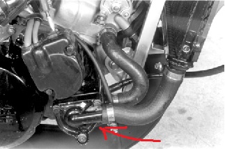

hmms. can't determine it's oily or watery, due to only small drops of liquid. but i tink like what you said, it's coolant... 2t should have some odour right.
attached is a pic where i saw droplets of fluid dripping below it...
thats your water pump area your arrow is pointing towards..
maybe a loose/cracked coolant hose.
however if its the area slightly to the top left of your arrow, it's your 2t pump. so just take a clearer look to confirm.

should be coolant... do you know how much will it cost to get it checked and fixed? aga aga... haha.
prob you're looking at $10-20. depending on what cause the leak.
however don't quote me on the price. just a rough estimation based on past experience.
if hose crack near the opening. DIY, just cut off that part and its solved..
do make sure that there is sufficient length before u cut it.
And just make sure that the clip is tightened properly after that.
