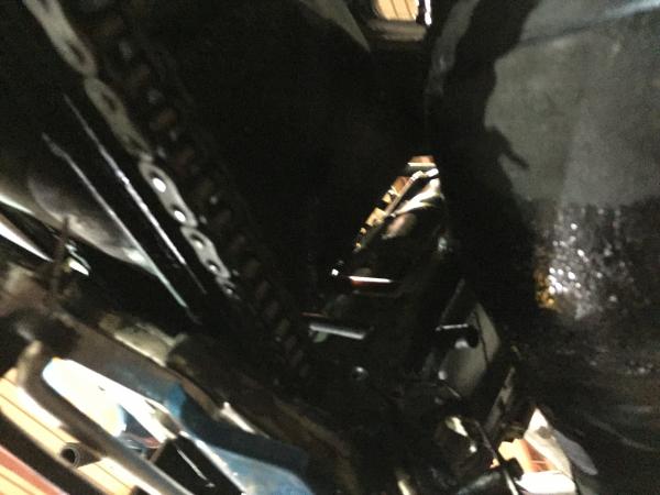

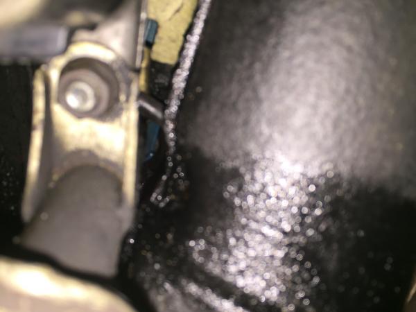

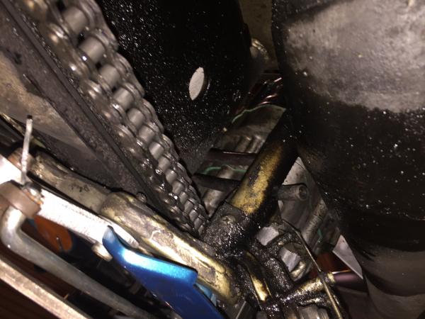

Hey guys! I'm posting my update:
Throttle is fixed and the problem seem to be that the grip was rubbing against the throttle casing. HAHAHAHAHHA
Oil problem still unable to identify. Attached pictures are the leaks that i'm talking about. Anyone can help identify?
Piston no problem at all, seems that it was other problems.

[ATTACH=CONFIG]321495[/ATTACH][ATTACH=CONFIG]321496[/ATTACH][ATTACH=CONFIG]321497[/ATTACH]
You could ask the spray painter to repair for you.
To be honest. I also didn't feel it at first when the rc valve open. Only a slight difference, and you'll see the rpm go up faster. As for the leak quite hard to determine from the picture but from the location it might be from your oil hoses.
Think your 2t hose or the reservoir leaking. Careful when riding
