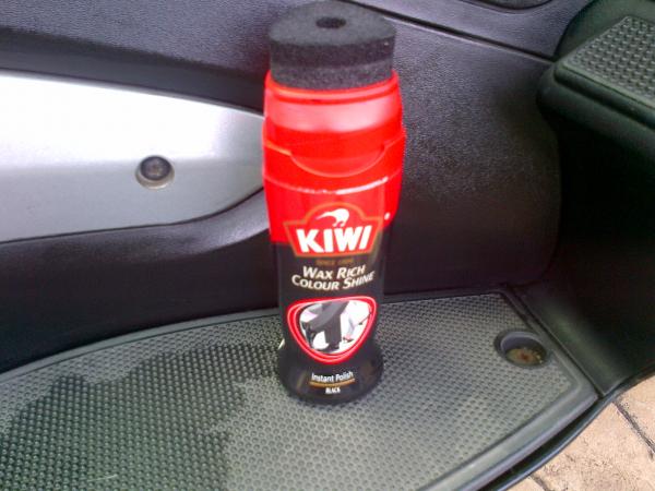

I researched on the internet about restoration methods for vehicle bumpers as I realise that the material for my gilera's dashboard was quite similar to car's bumper. I found lots of methods including using heat gun, tyre dye (quite expensive) but the one most convincing have to be liquid kiwi. The condition for my gilera dashboard was quite "chui". Therefore I felt that there is nothing to lose and went ahead.
The kiwi comes with a foam head which is pretty good but it is best to buy a small foam brush to apply to hard to reach area and avoiding getting the kiwi on your painted body panels. However even if it gets on the body panel, I was still able to get them off just using cloth (best to use masking tape to prevent this mess but I was lazy).

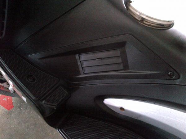

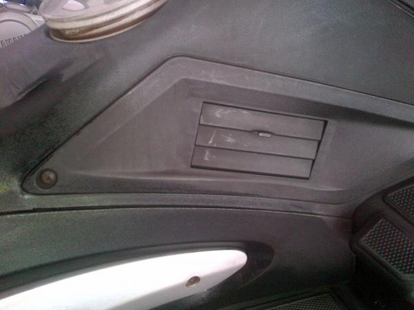

This are the results:
Before
After

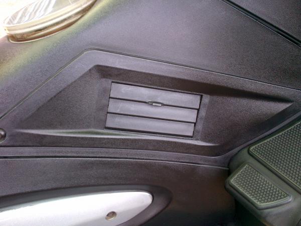

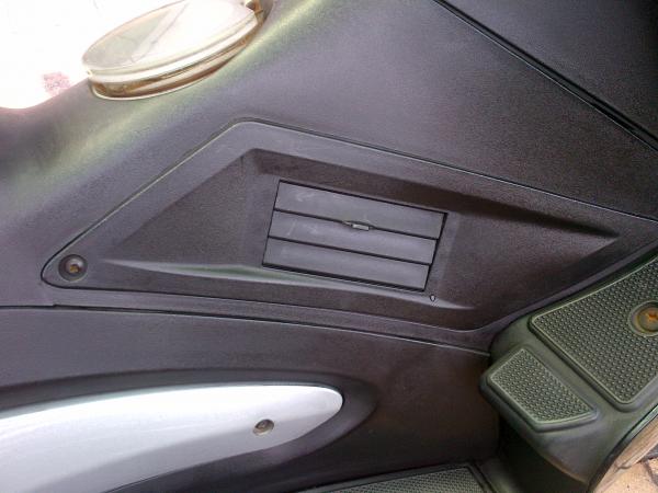

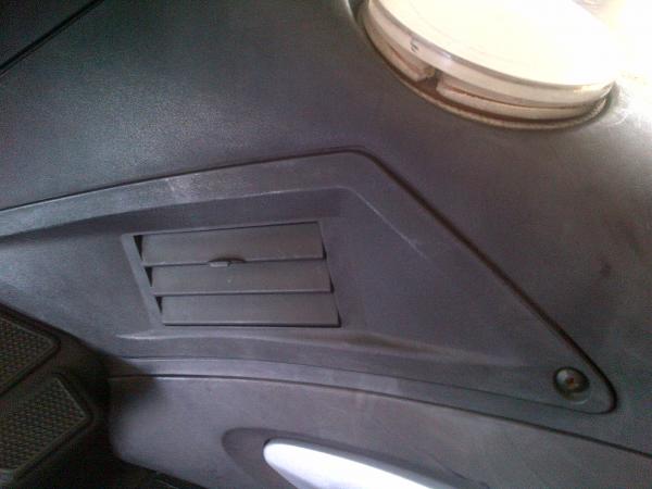

The post on other forums suggested 2 coats but I went ahead with more. Unsurprisingly, each additional coat make the result better. I applied 4 coats total with around 5 mins in between (it dries up pretty fast).
No Coat
2nd Coat
3rd Coat
Even after 4 coats I still have around half a bottle left and I went ahead and "kiwied" the floor mat as well.
The result is pretty good considering one tube only cost less then $5. Will probably apply one last coat tomorrow after it had really dried up evenly.
The end result is a little glossy due to the waxy nature of the liquid kiwi. It dries really fast and it doesn't stain my hand even when I rub on it.
