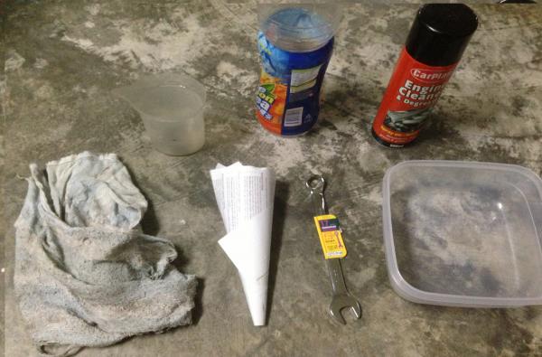

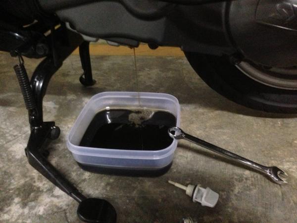

Anw i cann't wait till tml coz today i reached 1k plus wanna to change the oil badly, so i decided to do it myself.
Below is what i use to change hope it help for some of you:
1. Square Tuberware that is more then 1l
2. A4 size paper fold and roll and tape it
3. 1 empty 1.5l bottle fill half with water to wash hand and fill up the left over oil.
4. 17mm wretch from Daiso
5. Small container measured 200ml
6. Used cloth
7. Engine de-grease clearer (Optional)
Total Cost: Maxima extra4 10w40 $23.70, 17mm wretch $2, the rest you can find it in your house.
Tips: Main-stand the bike let the oil flow for 5min then side-stand, always adjust the tupperware to catch the oil properly, know which side to turn for the nut.
