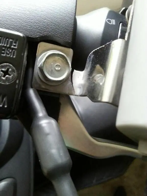

Try to shake your rear master brake. If you can shake it then there is the noise coming from

Bro, actually you don't need the holder. I mounted my new type iu unit just on the flap above the meters using heavy duty 3M clear mounting tape. It been through heavy rain and shine for almost 2 years so far very stable. ERP also no problem. Only need to re-route the wiring.
