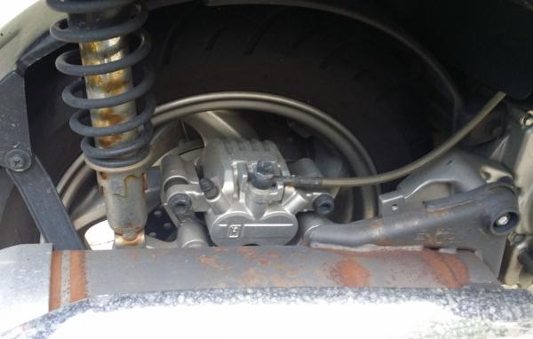

Hi Bro, my bike less than 2 years, the exhaust pipe condition get rusty badly. Is there anywhere I can change a better and cheaper pipe or not? Beside the piping, the suspension also rusty too. Any advice and the cost??
Feeling sad...
bro, I riding GTS200, my advice , dun buy. parts are bad. My bike less than 2 years, lots of problem, everywhere rusty. On ofCapture.jpg my friend also affected. the whole exhaust pipe dropped at highway.. very horrible.
I would suggest to ask workshop to repaint it with high temp paint. Buying a stock exhuast shd be ard$500,might as well get gpr.
For rear shock, can change new one or just give it a good clean ;)
I also got problem with my stock exhaust... some senior riders says its cos by a broken wielding inside the endcan... whenever i move off there is a cling cling sound from my endcan. So end up i change to GPR...

I got a quote from Mah:
The new exhaust cost $463, and the behind suspension cost $60 each,
Labour is not included, estimate $60 for this 2 item replacement.
Kindly advice whether should I goes for it or not? I worry 2 years later need to change again!
I keep telling other of my friend not to buy SYM. They parts are like suck!
The pipe can sand off n spray hi tempt paint. Its only the extrior..unless the inside is also broke.
For suspension. If it is only the superficial rust. Use wire brush to get the rust off. N polish it wif maguir or autosol(cheaper version). Unless the rust is in depth n affect the suspension structural integrity.
Everytime rain. To wipe it off dry to maintain it.
Hope it helps
