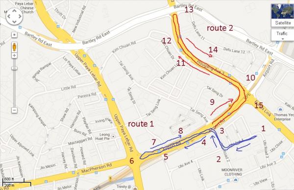

continuation of lesson 7 guide:
ROUTE 1.
CDC is 1
come out of cdc turn right. at the exit it is a stop line so STOP. if on right side of the lane, check back left since its a kerb. if on left side of the lane check back right.
proceed down ubi ave 4. near the traffic light prepare to turn right. this is at junction marked 2. single row at the lights.
after turning right start to filter to the left getting ready to turn left. you will turn from ubi road 2 to airport road at junction 3.
remember to ensure two lanes are clear before you enter airport road from the filter lane. first potential problem is here. the first lane on airport road goes to KPE. so you must immediately signal right AFTER turning into the lane and filter to the second lane so that you don't end up going into KPE. this is at the spot i marked 4
go straight along this lane until you pass the chevron markings on your left (where the road splits towards KPE). this is your reference point for filtering one more lane to the right. this is around where i marked 8 (on the opposite lane).
shortly after this you will see an overhead bridge. as you pass under it you should filter to the right most lane and prepare to make a u-turn. this is around #5.
note on lane changing.. apart from the one at #4 which must be done immediately, the rest are just guides.. you will need to assess the traffic situation by looking in your mirror and sometimes you will need to change earlier or later. but make it smooth.. any sudden changes will attract demerits
at junction 6 you have to make a u-turn. how you do it depends on a few things.. what color is the light when you arrive, which bike are you in the form up etc. few things to note - if you are first bike and lights change to green (round green so must wait for oncoming traffic to clear), you inch forward and position your front tyre inside the 2 pedestrian white lines.. when you see clear traffic or the light changes to green arrow proceed to make your u-turn. you must not go past the second white pedestrian line and you must make your turn into the second lane from the right. use half clutch gear 1 techique. if you are riding towards junction 6 and the light is already green arrow just shift down to second gear and proceed to u turn without stopping.
after u-turn... stay in this lane until you pass the filter lane for traffic coming into airport road from macpherson road.. before where i marked 7. then signal left and filter into the left most lane.
before number 8 you will pass a bus stop. you should start to filter right one lane here... then about half way down or around #8 filter again to the right most lane and prepare to turn right at junction 3.
proceed to turn right as per normal (traffic lights are with green arrow type), and head back to cdc
ROUTE 2:
after turning right you will now turn right at junction 3 not left like route 1.
after turning right.. filter to the left lane. along #9 and prepare to turn left into hougang ave 3. this is a major road. be very careful esp of large cement trunks
long stretch of road ahead all the way up to 11. if its bus lane hours remember to switch to the second lane immediately after turning left at the junction 10. if not bus lane timing then keep to left lane. around 11 you should be able to see an overhead bridge in the distance... you can filter one lane from her to 12. by the time you pass 12 you should be filtering to the right most lane and prepare to make a u-turn at 13.
same u-turn procedure as route 1. just be extra careful coz major road. i suggest don't proceed until green arrow comes on.
after u-turn, same thing into second lane from right, wait until you pass the filter lane for cars turning into hougang ave 3 before you filter back to the left most lane.
around 14 after you pass the overhead bridge you start your journey to filter to the right.
for route 2 very important difference for your right turn back to airport road at junction 10/15:
when you arrive at junction 15, there are 2 right turn lanes. and the traffic light has a red right turn arrow.
TP wants us to use the second from right lane to turn (meaning we are not going to be next to the kerb when we turn right unlike all the other right turns. so there will be traffic on our left going straight and traffic on our right turning right with us.
when u start your turn when the GREEN ARROW turns on... make sure you turn into the SECOND LANE FROM THE RIGHT, not the right-most lane like usual. be very careful as there are cars on your right throughout the turn. best strategy, go straight until you are halfway into the yellow box before turning right.
after that, as usual, wait to pass the filter lane of cars coming into airport road from the left then filter left, turn left at 3 and head back to cdc.
good luck!
[ATTACH=CONFIG]283529[/ATTACH]
ROUTE 1.
CDC is 1
ROUTE 2:
good luck!
ROUTE 1.
CDC is 1
ROUTE 2:
good luck!
