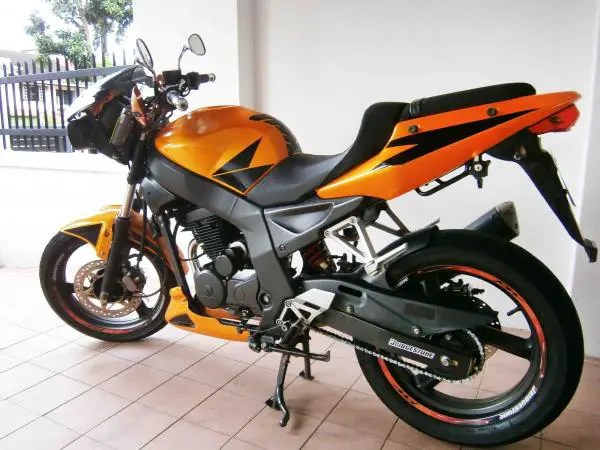

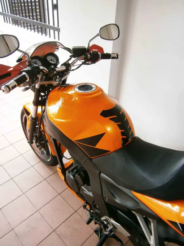

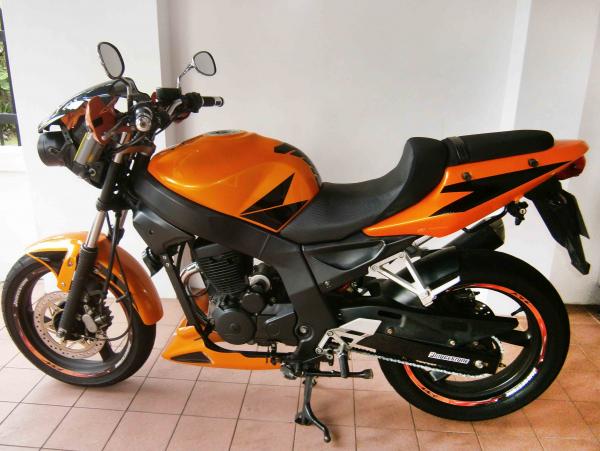

hi guys, just wanted to say that this thread has been a great resource for me over the past two years. thank you stsoh and all the other forum members for all the well researched information and advice that you have all dispensed here.
i bought my roadwin second hand in 2009 and it has been a great experience riding and owning one so far. i'm actually thinking of selling it because i recently bought a car. hence (as you can probably tell) i'm trying to reach the minimum number of posts required before i can post an ad on the used bike sales section.
that said, i just renewed my road tax and insurance so i'll probably only sell a few months later. in the meantime, i'll continue to ride my roadwin on the weekends and decide if it makes sense for me to own two vehicles. i really do like the roadwin's look! :)
