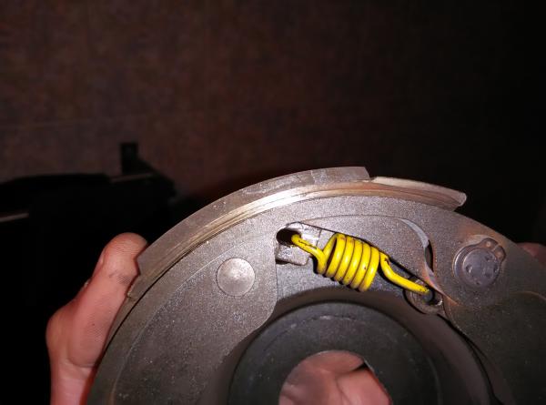

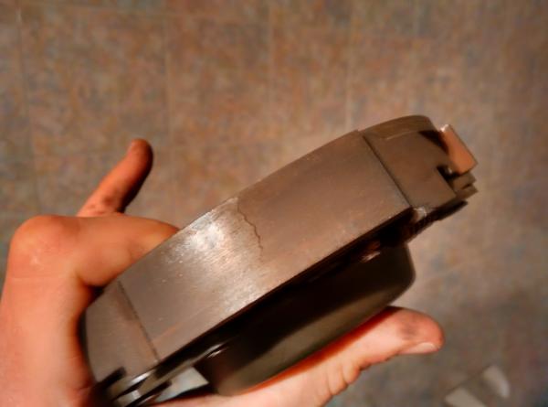

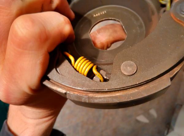

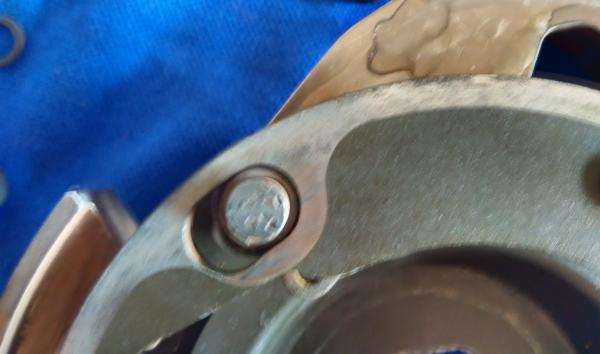

At the fist look it seems like Dr Pulley HIT clutch for Xciting 400i have a serious linet problem. Mine after a few kilometers with the preinstalled springs looks like the photos I have attached to the end.
I contacted more than a month ago to Dr Pulley and their representator told me that they will send me a new set off weights. That set never dispached!
I a'm almost sure that the problem with this HIT is not just the the shoe pads.
http://i48.photobucket.com/albums/f215/user42/th_VID_20150401_173616_zpsshl63fui.mp4
My first mail with Dr Pulley was the following:

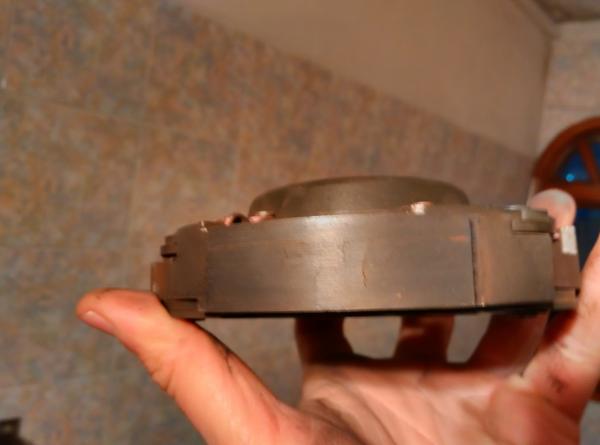

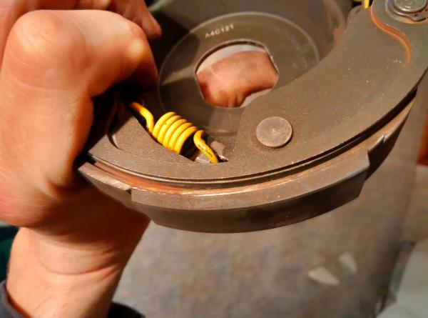

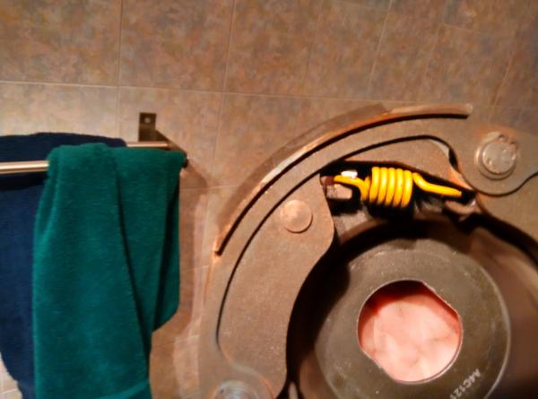

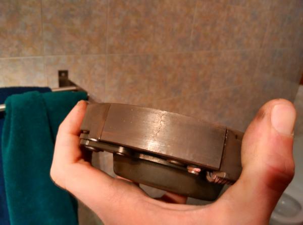

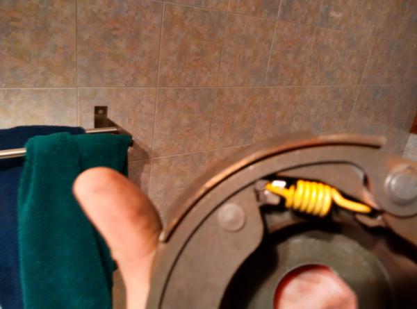

I just opened my transmission and what i saw made me very disappointing about HIT clutch.
I own a HIT 252001 for Xciting 400i.
I have been using Dr Pulley clutch for about 3500 km. I bought HIT on 15/10/2014.
I hope that i got a faulty clutch because this is a major problem.
Two clutch pads are full of cracks. The cracks are not only on the top off the pads but some off them go all the way down to the weight. I include some photos for you to see the problem.
I would like Dr Pulley replace these pads as faulty because they give me shuddering on clutch engagement even if the motorcycle is moving. Off course, i tried a new outer clutch bell but the problem remains. I am afraid that the shoe pads will break apart very soon if i keep using this clutch as my workshop already warned me .
Although Dr Pulley representator told me he understands my problem they never replaceced the clutch, neither the shoe pads. See the attached photos and the video off a 3500 Dr Pulley clutch. You can make your own conclusions about Dr Pulley reliability as a product, and ever more as a company.
Think twice before spending 300 euros on a clutch that might be faulty and never replaced. IMG_20150331_202433_HDR.jpgIMG_20150331_202422_HDR.jpgIMG_20150331_202449_HDR.jpgIMG_20150331_202358.jpgIMG_20150331_202352.jpgIMG_20150331_202408.jpg

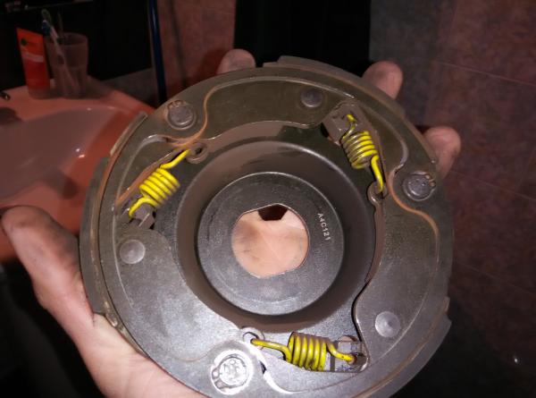

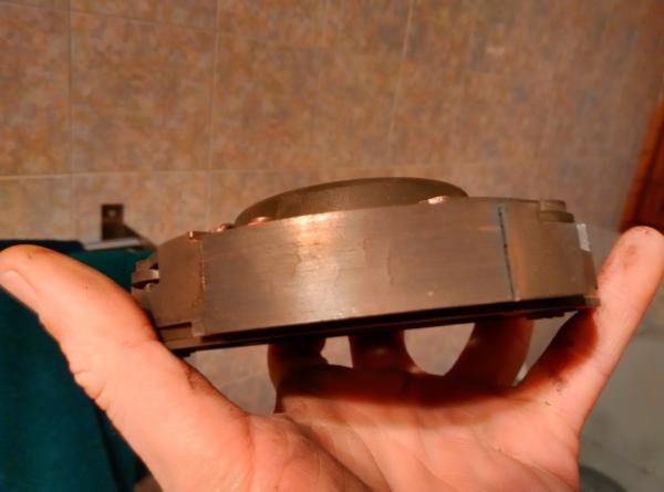

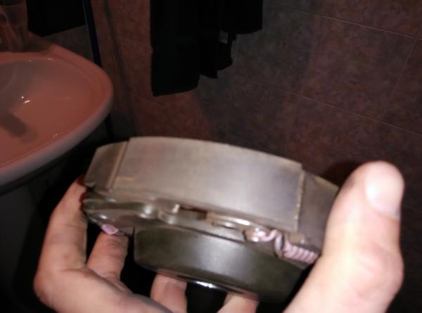

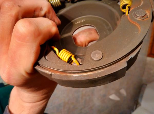

Yeah can see the crack clearly onto the linet, maybe the noise on VID is coming from somewhere near the pushpin?
The TechPulley X4 clutch 2015 that I bought from Bike James got probable other linet material then your Dr Pulley clutch.
http://freeimagehosting.nl/site2/image.php?di=KRYQ
http://freeimagehosting.nl/site2/image.php?di=V5MF
http://freeimagehosting.nl/site2/image.php?di=J6Q4
2015 model X4Kiss Clutch got improved bigger linet.
http://freeimagehosting.nl/site2/image.php?di=2QP5
http://freeimagehosting.nl/site2/image.php?di=P6FN
http://freeimagehosting.nl/site2/image.php?di=EEMN
http://freeimagehosting.nl/site2/image.php?di=UGB8
http://freeimagehosting.nl/site2/image.php?di=ZIX9
http://freeimagehosting.nl/site2/image.php?di=17AW
http://freeimagehosting.nl/site2/image.php?di=5PWY
pic source TechPulley Wu

Yes it seems to have different material. I really can not find the exact part that causes the ringing. Y@n did you watch the video i uploaded?
The cracks for sure are a major fault. I thought Dr Pulley is advertized for it's long life and quality. I think my case debunks the myth. I will try to inform every potencial byer of Dr Pulley products to know about this case and protect his money.

On my pics you cant see the linet clearly, but the linet is made from a grey/black material with copper flakes in it. First I thought that the TechPulley clutch was just a copycat from dr. P clutch.... but the inventor him self: sir Wu from Techpulley Taiwan convinced me to try out this new 2015 version with those improved linet.
And so far so good, much better throttle response and low/mid acceleration... loving it.

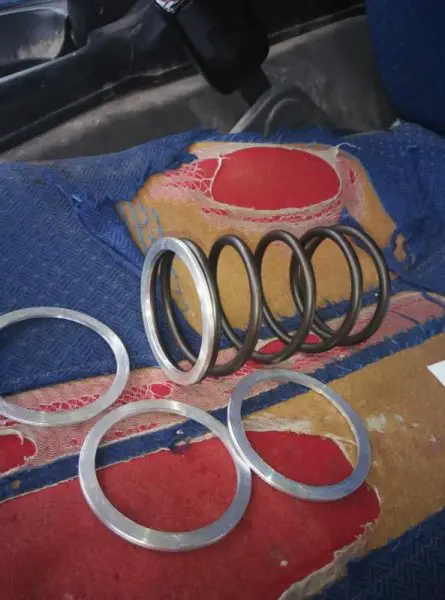

userGR,
could you expand a bit on the washers on the torque spring ? I don't understand how you do that. The idea is to compress the spring a bit more, right ? why not get a TechPulley at +20% versus the Malossi at +13% then ?

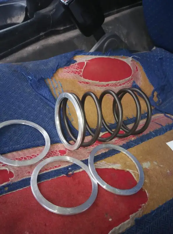

Preload
Yes: The idea is to compress the spring a bit more!
Just a bit, as you already wrote. TechPulley is +20% and the Malossi is +13%.
The OEM spring is much softer and besides that, the OEM spring becomes more softer easily with some thousands kilometers of use.
The spring preload is needed especially if you use a lock up clutch like HIT or TECHPULLEY.
If you don’t preload your torgue spring you will get belt slippage very often!
Dr Pulley rollers 15 or 16 gr works pretty well with the OEM variator, a little extra bonus is given with the torgue spring preload. 2mm with the 15gr rollers and 4mm with the 16gr rollers. The use of the preload washers or a little harder torgue spring is necessarily needed with lock up clutches…
If you don’t exaggerate with the preload it is a nice and cheap bonus to your transmission performance! IMG_20150504_123451_zpsxhiibhnq.jpg

Oh custom pre-load looks good ;)

Yeah can see the crack clearly onto the linet, maybe the noise on VID is coming from the pushpin?
I broke apart my HIT clutch and i found where the noise comes from!
See the attached photo and the difference in the hole size.
The driver ring shaped washer is much smaller in size!
Also the wear of the main body of the clutch looks pretty bad.
