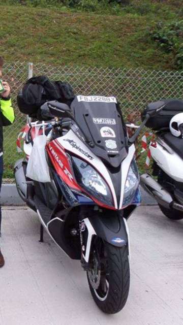

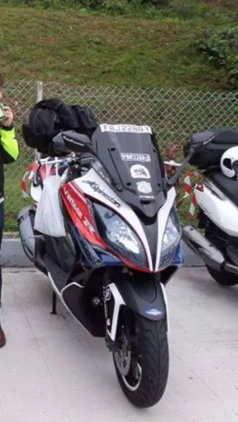

haha..yea it's me=) i removed all my sticker already..
what information u need?
I like the color sceme. If permitted, i would like to have your full picture of the design and maybe will consider to replicate it at my bike. It looks elegant.
