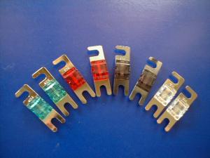

Sorry for hijacking your thread, technicolorhighway.
@strong eagle - Hi, do you know where to get AFS fuse in singapore? You looked liked you might know sth.
