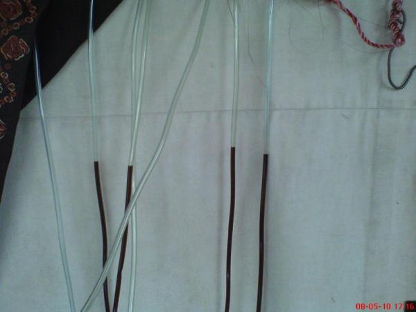

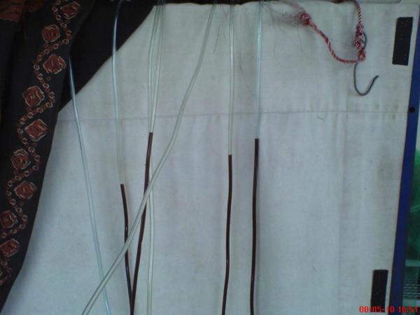

was trying to fix that when i was doing a throttle body synch. problem is the TPS sensor is apparently blocked by the frame on the gsr4. cannot get to the torx screw without unbolting the throttle bodies and removing it. anyway, after the throttle body synch (cyl 1 and 2 were way off), engine became much smoother at idle. :D really love riding it now.
manual was a little deceptive, says there are balance screws, but all there are are idle air screws.
just to share, left is pre-TBS, right is post-TBS.
