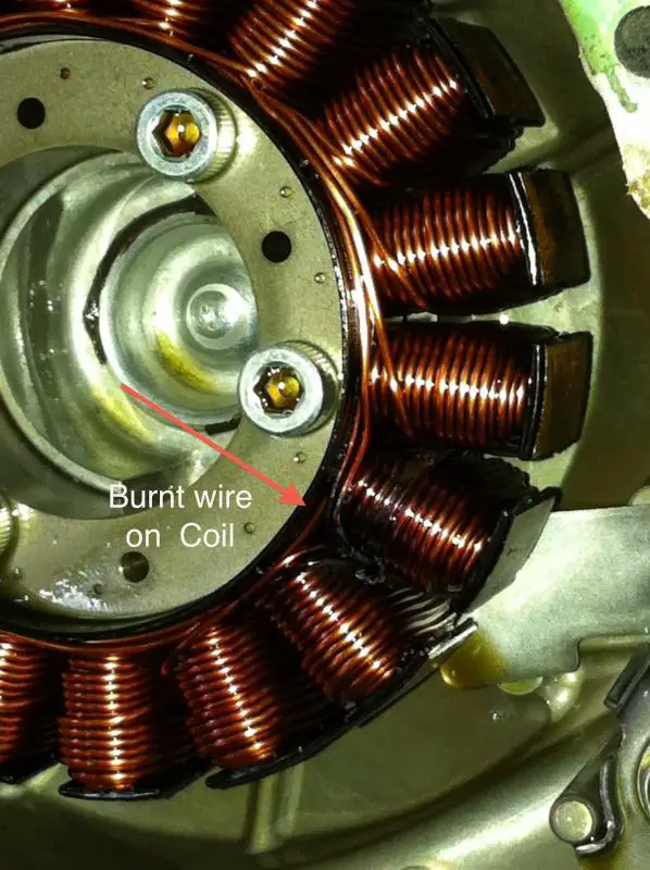

This is an update on the issue first mentioned here.
Since replacing the battery, the needles still sweep around the meters on ignition. This persisted throughout the 2 weeks before my trip (see below). However, I had no problem starting the bike on first crank everyday.
I went on a trip with some mates last weekend. We started the trip at night and it was quite a cool ride (for ambient temperature reference). This is the first chance I had to “test” my Revo since buying the bike a few weeks ago, so I decided to run it at higher speeds. After about an hour plus of riding between 165-185km/h on the NS Highway, the oil pressure light came on. Then the meters died, i.e. digital info like trip meter, fuel gauge and clock went blank. Both RPM and speedo needles then went to zero and the bike began to stutter.
Point to note is that I have done these over the few weeks prior to the trip:

Other than the needles sweeping on ignition, I thought the bike should be good to go.
While parked on the emergency lane we checked the usual suspects (coolant leaks, fuses and etc.) and could not detect any obvious faults. Tried to jump-start by connecting the battery to a truck battery. It started but once the cables were disconnected, the bike died shortly after. That only meant that either the rectifier or alternator (magnet coil) or both had failed. Long story short, this is the cause:
Note that the rectifier is ok. With a new magnet coil installed, the meter needles now do not sweep around on ignition.

OMG lets all sign a petition for a recall. mine also has the double sweep. btw are u going to call up boon siew to screw them? i hope you do. exhaust ur warranty bro. claim for whatever repair costs needed. update us,

Sorry to hear that, as usual Ah Pek was correct again the coil is the problem. SO ALL REVORIANS brace yourselves and keep asking Boon Siew to replace while you still have warranty.
Thanks for sharing Ram snake, this is most vital information.
All REVORIANS please fault sharing is crucial, hope to see you guys step forward and we can bring Boon Siew DOWN!!!! haha just kidding
